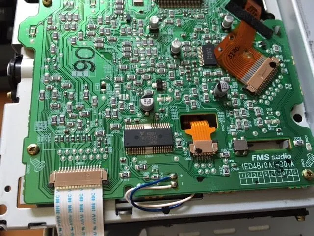

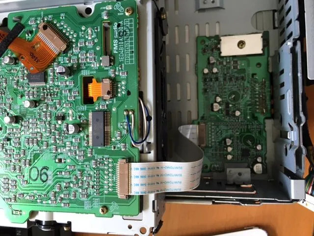

First pics of the stereo opened up

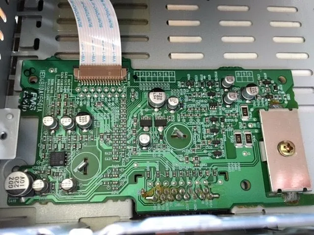

Lower PCB board (under the CD player)
Upper cd board (attached to underside of CD player)

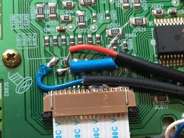

Upper board after wires soldered:
Pinout is the same as the (labelled) connector on the lower board. The ribbon cable is direct pin to pin after all. So from left on the top row you have audio right, audio left. On the bottom row the LHS pin is audio ground. Do use hot glue to anchor the cables before you solder them!

- a magnetised small crosspoint Philips screwdriver will be very handy for removing the CD player, as the two screws at the front are buried deep
- remember to thread the audio cable / cables thru holes in the case BEFORE you hot glue and solder them
- I soldered to the top board (the one which is attached to underside of the CD player) and found this much easier than the lower board, as it's more accessible. Even though the lower board is the one which is labelled, the connections do of course make it through that ribbon cable in a straight line, so you can see easily enough where they appear on the top board.
- use hot glue to hold the cable close to the solder connections, and more to anchor the cable as it leaves the PCB. Use a cable tie to strain relieve the cables as they pass through the radio case. You don't want to be taking the radio apart and resoldering because someone dropped their phone and gave the audio cable a tug.
