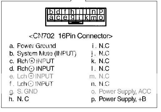

Ok, here is the PIN assignment for the connector on HU in my 6 (Matsushita Electric CR-YM4272K).
Pins mentioned in this mod (1-15) are lower row (a-o).
Does anyone have the manufacturer's layout of pins for the HU models on which this mod was successful?
If so, we could compare them, and possibly come to a solution for older models, and nicely round up this thread.

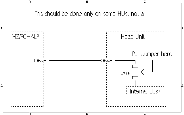

Also, i've seen many conversations about L716 mod. And some of them are showing this image:
I guess Bus+ here is new port you enable with mod L716.
Is there any special signal that needs to come on this port or this is the pin that is being shorted in this thread?
and looking at that pinout, its the same. except in ours, pin 13/m is where we get our media button from.

For those of you with Hum / Noise issues (well everyone else actually also):
You should NOT be connecting the Audio Ground (i.e. the bare copper shield from the audio cable) to Pin number 7. This is a Signal Ground (i.e. for communications, not audio). The proper Ground for the Audio would be Pins 4 and 6 (Labelled RH- and LH- in various pictures in this thread).
So, the RH+ (Pin 3) and RH- (Pin 4) are the RIGHT AUDIO signal (+) and AUDIO ground (-)
and the LH+ (Pin 5) and LH- (Pin 6) are the LEFT AUDIO signal (+) and AUDIO ground (-)
Do not confuse the '-' or AUDIO Grounds with the chassis or power (12Volt) ground or the Signal ground - this is what is causing any humm.
Best way would be to tie the two AUDIO grounds together and to the SHIELD of your Audio cable.
