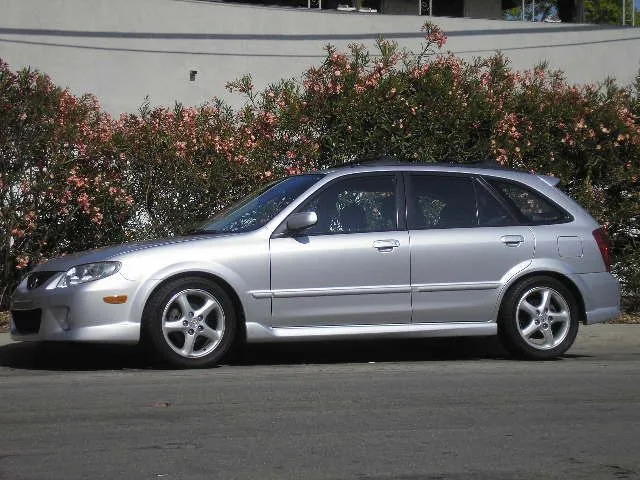

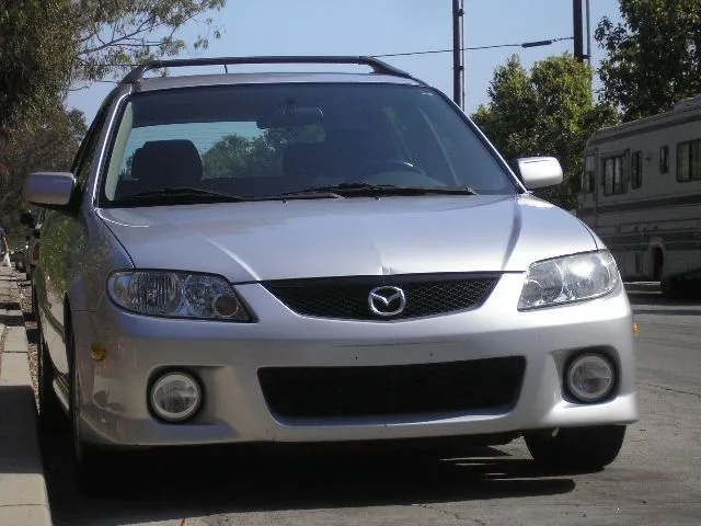

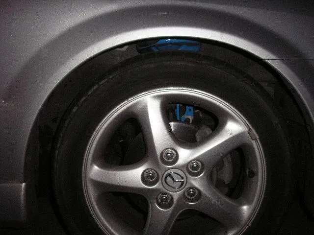

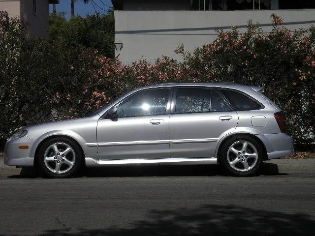

Pics of Eibach Pro/Tokico HP
Well I took a bunch of pics but it was too dark outside, here is one that came out ok, I will take some more and update it tomorrow.
If you look at the center of pic1 the camera is angled up, there is slighly less space between the wheel and fender than it shows. But you can see the blue beauty.
