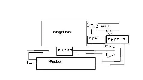

to bump an old thread, i had a question...
i recently did the maf relocation so that my greddy type-s (vta) is sitting before the maf on the coldpipe...i get turkey unless i remove a spring in the type-s and then it just leaks...can i hook up the stock msp bpv on the coldpipe after the maf to recirc to my intake without any issues?
Hmm. If you recirculate (measured air) from after the maf to before it, it will get counted again. Almost seems like it would do the opposite of a BOV setup on a car with the MAF on the intake.
Venting measured air via BOV with MAF on intake = rich.
Venting unmeasured air via BOV with MAF upstream = normal.
Venting measured air back into the system and measuring again = ???.
Let me ponder this for a bit... I have no testing available for it and I don't know anyone who has tried it before, but I have a feeling it would run less than optimal.
yeah...i was unsure about that...it just seems that even while im running full vta, im getting turkey...but from talking with a few people on mocc, im assuming its cause im running soo very little boost...
