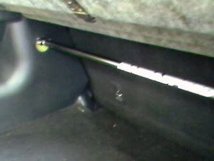

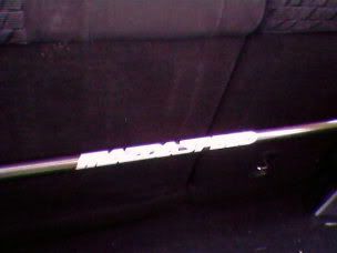

Noticed an amazing difference. It cut my body role in half. An amazing mod for only $20. I just installed mine. Here are some pics.
That looks great! I'm glad you like it. It's one of those too good to be true type deals. I wished those sellers on ebay would lower the shipping cost, but I'm sure that's how they make their money.
