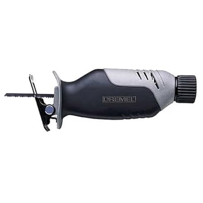

i dont have a jigsaw :-( wud a dremel saw attachment w/ a metal cutting blade be strong enough to cut it or not?
does anyone know if the dremel saw attachment will get through the seatbelt bracket? It says it takes U and T-Shank jigsaw blades...so do you think it will be good enough to cut them?
That should do it. I used a jigsaw with a metal cutting blade. It is suprisingly easy to cut through. Knife through butter

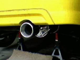

Best way to do it is jack it up from the center of the rear axle, there are also a few other solid parts near the center of the axle you could jack it up on. It would also be smart to put a jack stand on each side of the rear axle once you jack it up from the center. Here is a pic of a good what it should look like:
i got it to fit on the rear axle. I didnt think the jack would get it high enough but it got the wheels about 1.5 inches off the ground. so its back on. i had to extend the bar about a half cm to get it to fit once the weight was off. so its on good now
