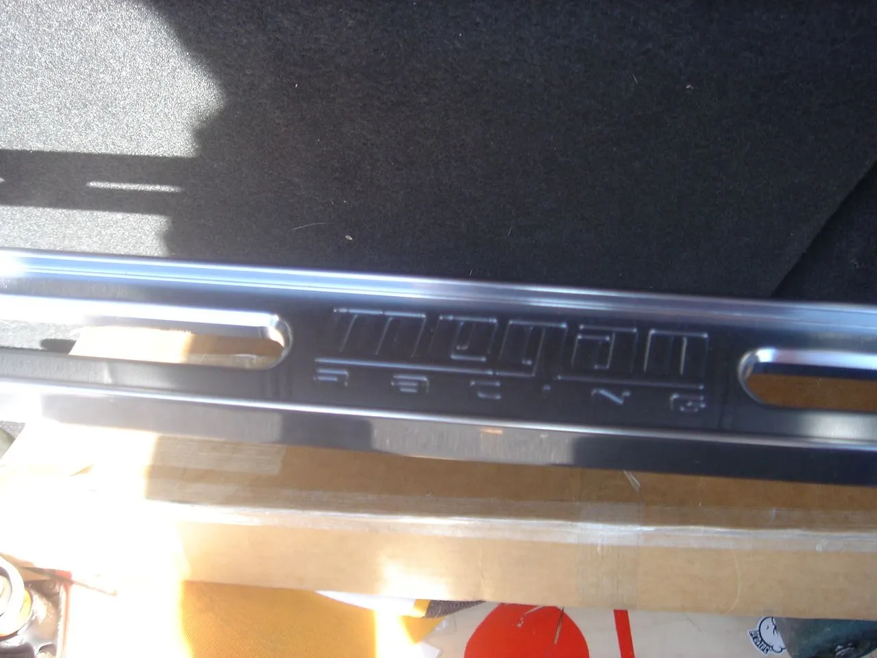

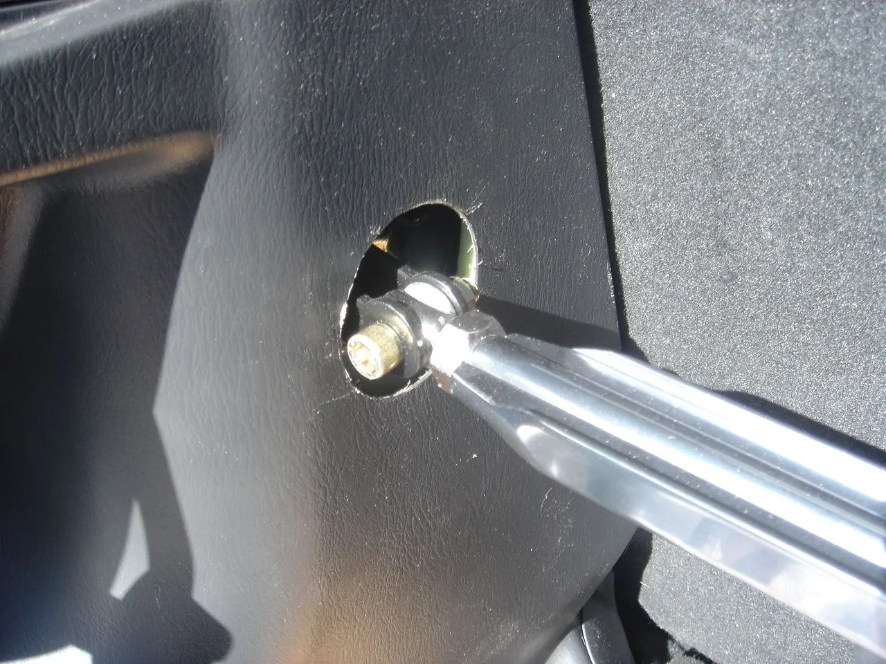

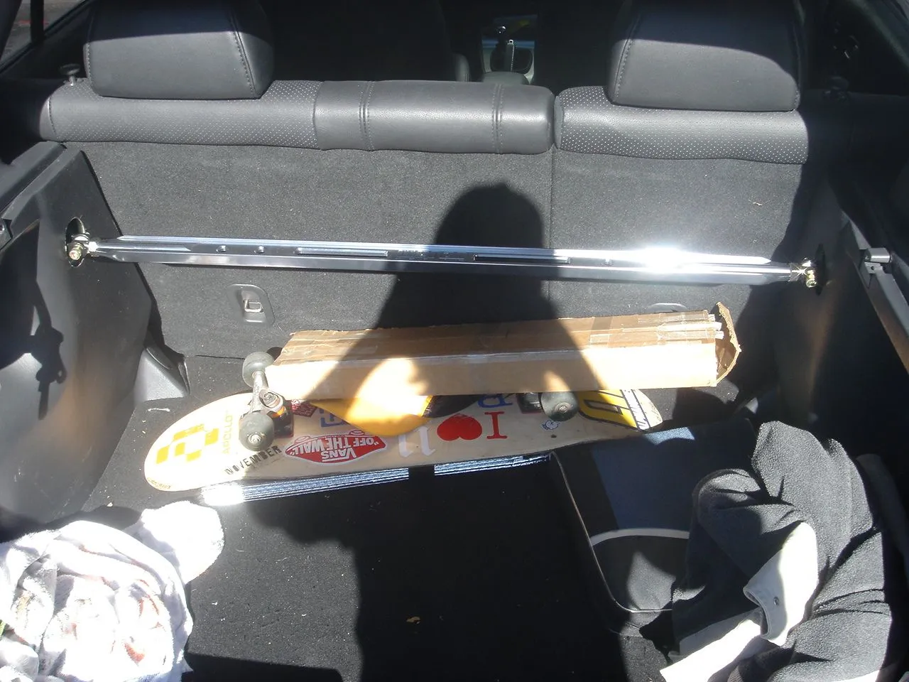

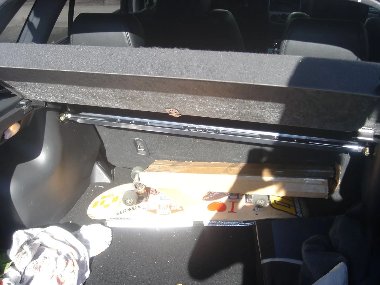

So my laziness finally subsided, and I took some pics of the megan. Pardon the dirty hatch, it's my home away from home. Also, you should enjoy the bigger holes I had to cut because I can't measure worth a damn.

Wow, that megan bar looks nice (cool) you know, maybe you can cover up the big holes with a plastic boot from a plumbing store (kinda like a reducer boot, from 2-3" reduced to 1" & use a hose clamp to hold it to the bar).

Damn. That's hot.
Good going on the install.
Too bad for me. I cannot do it on my P5. I have the MSP sub/amp rack mounted using the stock brackets & mounts. I think it sits too low so the bar probably wouldn't work.

You like my install? I kinda rushed it, but the bar looks great, and doesn't hurt cargo space at all. I've been looking into a quick release with Clevis pins (like $1.57 at Home Depot), but haven't finished it yet. Either way, not a hard removal if I need the room. BTW, I think you should go for it, it may fit, and you can probably tweak it to if it won't.

I really like the look of the bar, very subtle, but beefy. If you look closely at the holes, the brackets aren't centered, they're towards the rear, so the boot probably wouldn't work. May give it a shot though. And yeah, very similar bracket, after an hour with my new angle grinder, I finally put in the seatbelt supports on top of the towers. Between me and another engineering major, we figure those are for crashes, made to take the bulk of the impact so the mechanism doesn't explode. You can roll without em, but I wouldn't recommend it.
