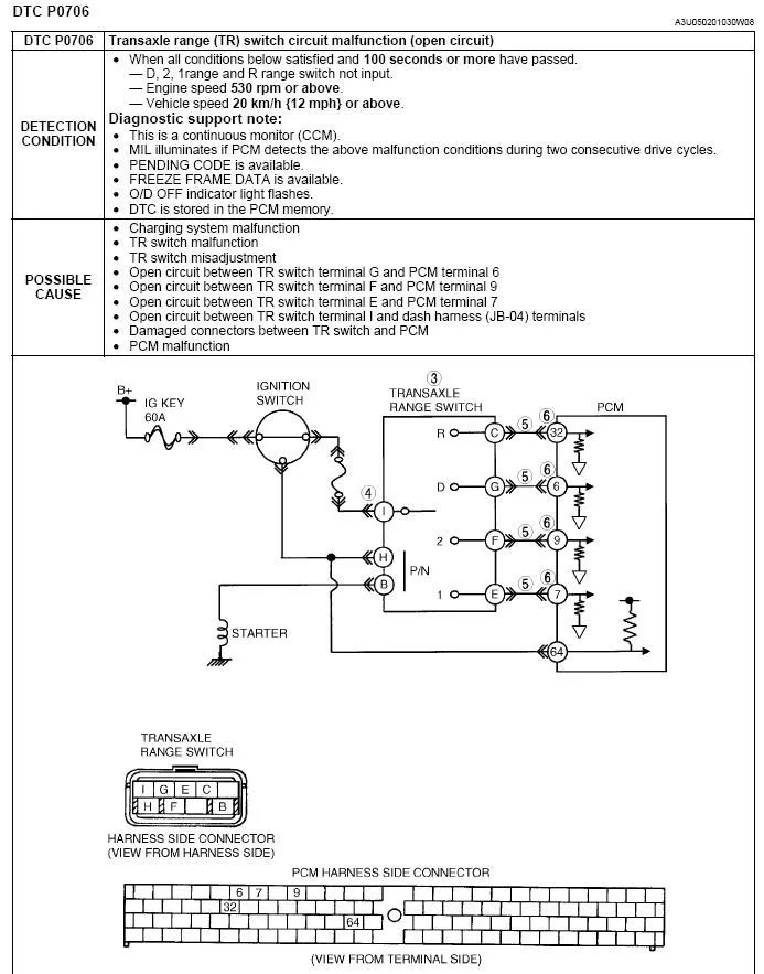

Ok I googled the problem, and it gave me a link to a manual on how to diagnose the problem. Well, is there a diagnostic tool that I need? I need help, and fast. We only have one car, and well, we need to get to work tomorrow. Thanks.
P0706
TR switch circuit
malfunction (Open circuit)
(ATX)
(See 05026 AUTOMATIC TRANSAXLE ON-BOARD DIAGNOSTIC FUNCTION)
Go Go Gadget shop manual ;)
If you want to do it yourself, page 2 is the diagnostic guide

Ok, I'm not a car mechanic, I'm trying to check for continuity between the wires, so do I use ac or dc on the voltmeter? The experts won't make it until tomorrow morning (pissed)
I believe it would be the up to 20V DC range setting on the dial... your car runs 12V DC power and since most don't have a 12V setting, it is 20V.
