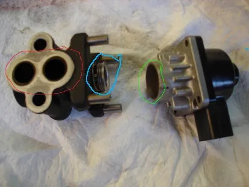

6. Lube the shaft inside with a drop or two of oil and also lube the outside beneath the spring.

Nice write-up... what kind of oil are we taking about here? Your standard 3-in-1 that comes in the red & white can or motor oil?
anyone?
mine is in two pieces as of now... hope 5w-30 works ;)
T3ase, glad it worked for you. If the valve is stuck open with deposits, it creates a vacuum leak and that causes the rough idle and stalling.
Yes I used standard motor oil, you could use lithium grease or 3'n'1.
Britt
clean the red, green, blue or both?
lube red, green, blue or both?
