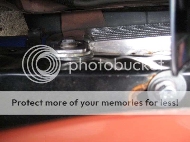

So speedaction20 how did you mount your ic to the bumper? Just drill holes through the top?
well I know this is really really overdue, but I was looking for the link for the slim fans to amazon and found this, I really need to take some actual pics of my setup, or how it's mounted and all that, but I had little tabs welded onto the back side of the IC, and just mounted them into the back of the bumper support that way, but I also drilled holes straight down and mounted 2 of the screw things to the IC that way.. the 3rd one was to much of a pain in unnecessary.. I was running out of patience at that point, and destroying my drill bits trying to get them to line up perfectly and enlarging the holes when they didn't..

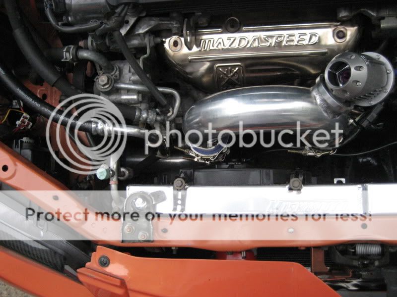

here are some actual pics of what I am talking about finally, the cold side I just went through the area like CS install says for the most part, and I couldn't get any real good pics of that area, but anyways.. very late but here ya go.
Overall view,+ the new horns I put in because the stock one sounds like a little roadrunner
Close up of the brackets I had welded on there and the bolts going through the top of the bumper support
Hot Side went like pretty much most peoples

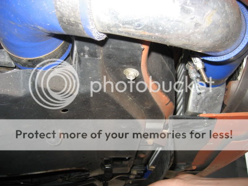

Bottom of the hot side, and how I connected to the IC, I had an IC that had inlets/outlets in the middle and not up high, and with the combination between cutting the bumper support to make it flush and the 45* couplers I had on there, I was able to get them under the fogs.. also I was able to have my mud guards there in tact and all screwed in, but a recent hit from a damn floor mat on the highway ripped that part off

Since it looks like your intercooler was the same as mine, do you remember what size/thread pitch bolts you got to mount it? That way I dont have to drag the damn thing into home depot lol
I bought my bolts from a hardware store. I measured the middle metal to the bottom metal and bought bolts a little longer then that to fit into the intercooler bolting section. I also bought 2 big washers from the hardware store also. Spent under $4 for bolts and washers.they are metric bolts.
I also bought a thin piece of metal sheeting from Home depot (cost me $4) that I can cut with my tin snips. I'm going to trace the outline of the SMIC and cut out a block off plate for the fan overhang. We'll see how that goes.
I think it was a m8 1.25 but I could be wrong. I have bad memorie. Lol. Just take the intercooler to the store .it's What I had to do.atleast u will know that u bought the right ones.Home depot didnt have a long enough bolt for me so that's why I had no choice but to go to the local hard ware store
