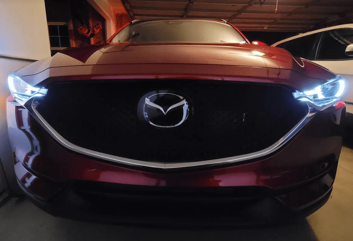

Can confirm this works on a 2021 CX-5 GTR. Took a few tries because you have to follow the instructions carefully and exactly as in post #165. Now I got halos only for DRLs. Well, I have the stalk set to parking lights/marker lights, but when I drive away they stay like this until I manually turn the lights fully on. My CX-5 was purchased in US in case that makes a difference.
So you followed instructions on post 165 and you can drive your car around with the halos looking like your picture? Because that’s exactly what I would like to do as well. Drive around with those halos as my DRLs and then TGIF the headlight to turn on at night (if you have it in auto). Do you have everything stock?
Yes this is 100% correct. CAREFULLY follow the instructions on post 165 you don't need to rush until you get to the stalk flicking and button mashing. You'll need move quickly through that section. I'd even recommend you practice it a few times. Yes, I have everything else stock. I don't use the auto function. I think you also have to keep your lights in the parking light position because the halos would otherwise be off. I keep my lights in the parking light position and turn on the headlights when it's prudent. Having the parking lights on also means your tail lights and marker lights will also be on but I'm okay with that since I like the look of the tail lights. I don't know how this affects the auto function. I'm in MI and I have an issue with auto head lights during daytime heavy snow events. We can have blizzard conditions here and people are driving around without their headlights on because it's bright enough to not trigger the auto headlights even though visibility is total s***. So, I've never used that functionality for this reason.
