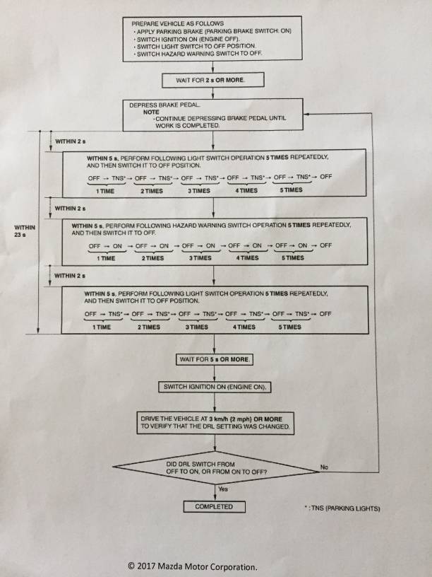

So I'm lost on 2 steps for my 2018.
Do I switch from off to auto, side light of full on?
Last step, after I complete the steps with feet on brakes, do I start car then disengage parking brake?
I copied this from somewhere, saved on my computer, but download the PDF in post #1, it has a picture for you.
I start with my lights switch in the off position.
Engaged emergency parking brakes.
Push ignition button twice.
Step on the brake and keep foot on brake the whole time.
Turn light switch to parking lights then back to off 5 times really quick (have to scroll pass auto if you have auto lights).
Then hit the hazards 10 times really quickly (basically on and off 5 times)
Turn light switch to parking lights then back to off 5 times again.
WAIT AT LEAST 5 Seconds
Disengage emergency parking brakes.
Release foot from brake pedal.
Push ignition button once to turn off.
Your DRL should be disabled now. Repeat steps to enable
Thanks! This work! This last part needs to be on it!

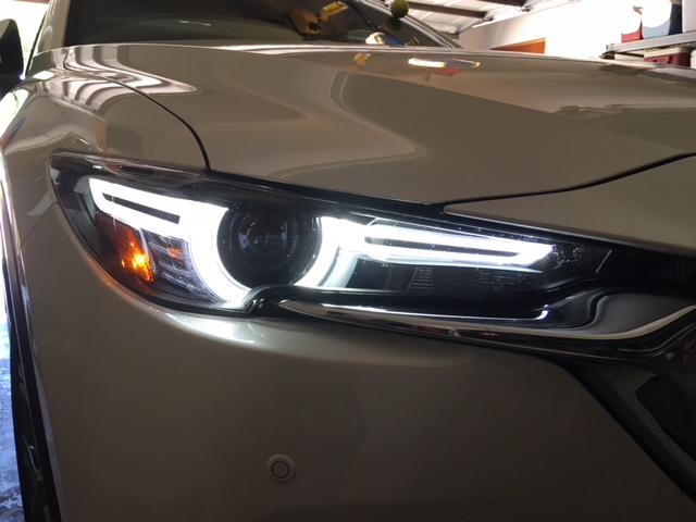

Got it on the first try. Not sure if I'll leave it that way though, I actually prefer the way it looks with the Parking Lights switch on, i.e., center round headlight off but halo and flat side lights remain on. It's technically illegal to drive in my state with just the parking lights on but this configuration looks similar to many other manufacturers' DRL's so I'm sure the popo wouldn't notice. I'll get stopped for the 25% tinted side windows long before having the parking lights in motion.
I agree, that's the best look we can get on KFs.
Again, for the record, here is an official copy of instruction to disable the DRL function for CX-5 obtained by bigtex from his Mazda dealer:
Is this the file:
Although the descriptions are diffetdnt in the last several steps, but they achieve the same purpose.
Yes, this way is the best looking setup on LED accent DRLs. 2016 and 2016.5 CX-5 have this way.
Don't the DRLs come on with the parking lights when you get in gear [when they're not disabled]?
Good question. On my 2016 CX-5, since the DRLs dont use low-beam LED headlights, LED DRL halos dim a bit when you turn the light switch to parking light position. Also the amber halogen parking lights / turn signals will be on (although I disabled the amber lights on parking).
I went by the PDF in post #1, I will repost here Courtesy of Rhino_66. I just found those other written instructions by someone else and it answered the poster question. No offense intended to anyone.

Does anyone know if this should work for a CX-30 too? For reference CX-30 has the electronic parking brake and Auto headlights. I’ve tried the different versions several times but no success thus far. Thanks.

I was able to get my 2018 GT on the first try, but I traded at the beginning of the year for a new 2019 GT and have tried many times to turn them off, once I start driving, they turn back on. :unsure:
The only thing that gave me a problem in the directions was to "turn on the ignition". I was using a single push to the start button and having failures. Once I realized that it took 2 pushes of the start button to turn the ignition on, the procedure worked perfectly.
