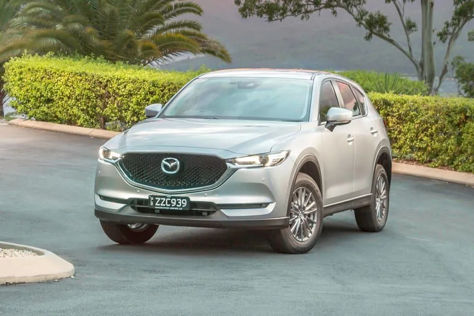

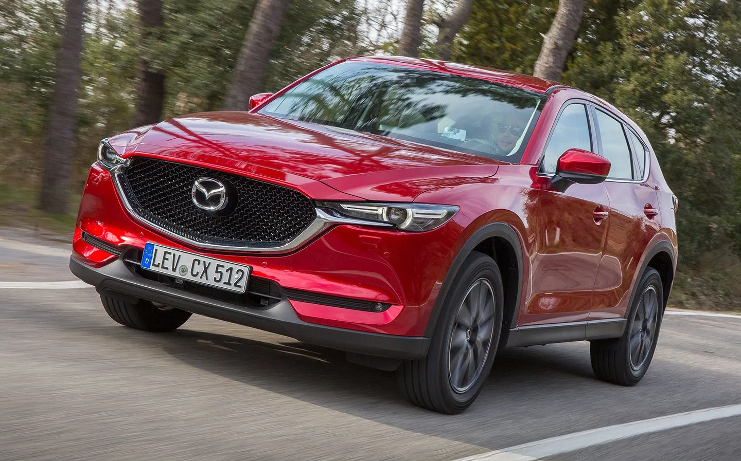

Just want to clarify, what Drewwitda22 did was he turned off the DRL function and turned on the parking lights all the time while driving. He gets front LED accent strips (halos) AND tail lights on all the time, and in theory, they’re not DRLs. And in certain states it’s illegal driving with parking lights on.
Gen-2 CX-5 in US and most other regions uses low-beam projectors AND LED accent strips (halos) for DRLs. Some versions of gen-2 CX-5 in other regions do use ONLY halos as DRLs like gen-1 2016 CX-5 with optional LED headlights. Unfortunately this’s something we can’t do on US version gen-2 CX-5 even though that’s the best DRL design on gen-2 CX-5 many have agreed upon.
2017 CX-5 drl question
2017 CX-5 drl question 2
2017 CX-5 drl question 3

Agreed. I didn't mean to imply that using just the halos was an acceptable replacement for the actual DRLs which is actually a low power state of the projector low beam. My state does not REQUIRE DRLs and it's not illegal to drive with only the parking lights/marker lights on. I turned off the DRLs because I just prefer the aesthetics of the halo only look like your pics above.

Correct. I just want the halo ONLY to be on at daytime w/o having to have the lights on parking. Meaning my preferences would be for the main headlight to follow the auto rules and keeping the halo on. Maybe what I want is not possible?
My last car was an Infinity Q50 2017. That one had accent DRLs (one that I absolutely love) and then when it started to get dark, the headlight would turn on. That's what I want? Am I asking too much Mazda? Lol...Maybe I am.

Like I said previously, what you want is not possible for US CX-5.

@yrwei52 I don't think it's been truly vetted yet that you can, after performing the DRL disable process, have just the halos and no other lights on anywhere else. I'll try to check it later to see what my vehicle does with the switch on auto and off both outside in the light and in the garage.
I would be in your debt.
Well...@yrwei52 was right. No halos only in auto. They only come on when the low beams come on as I pull into the garage. No halos in off either outside or in the garage. You can only get halos without the center beam when you have the running lights/parking lights on. Note that I have a 2021 GTR. Again, I'm okay with that and it's not illegal in my state.
To answer your other question, yes, the parking lights (or any light setting) will auto turn off after shutting the car off, closing the door and walking away assuming you have that setting on in the UI. I have mine set to the minimum and also to auto lock (which also folds in the mirrors) when I walk away after shutting down.
According to the mazda3 forum posts, there is a possible option to enable it through programming with forscan but nobody is brave enough to try it out. :)
So no, out of the box not possible on current generation CX-5 in US.
