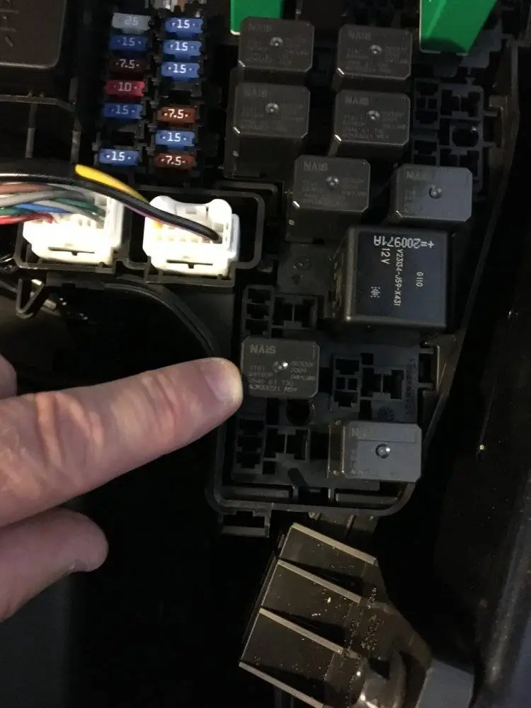

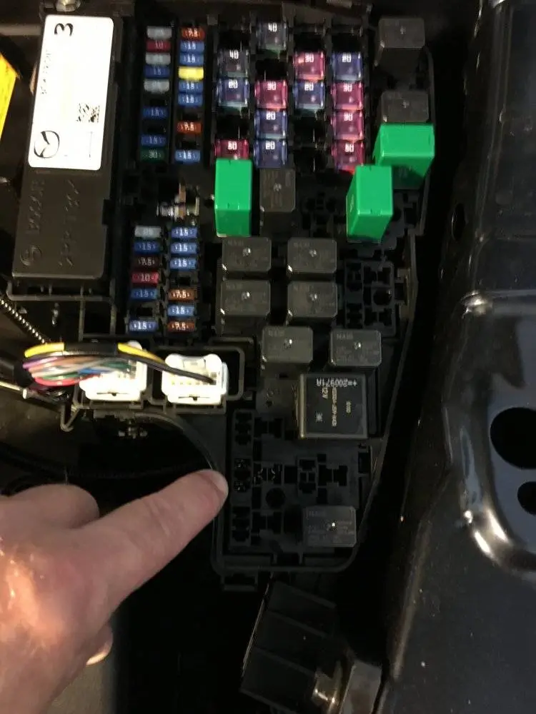

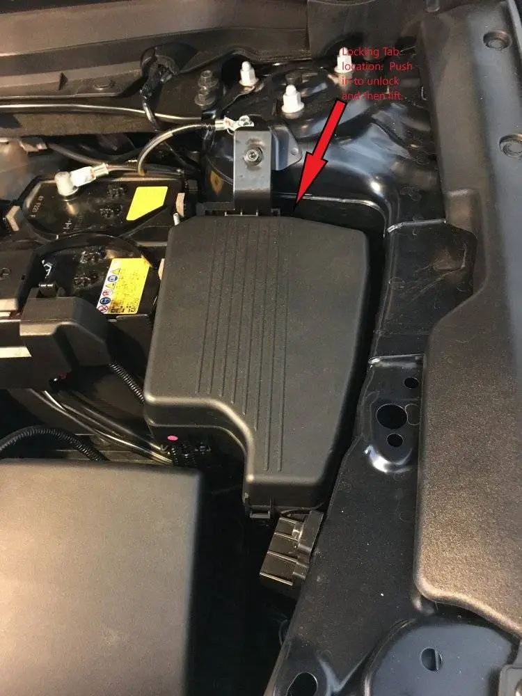

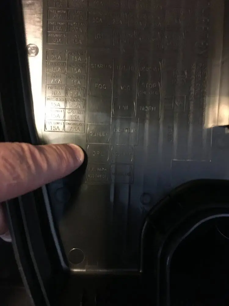

2021 CX-5 Signature (2.5L Turbo, AWD). I tried the preceding instructions (original post and post #165) to turn off the DRLs many(!) times without positive results. What I finally ended up doing was removing the DRL relay located in the engine compartment fuse box. No more DRLs. All other exterior lights (headlight low/high beams, all parking lights, turn signals, etc.) appear to work as expected. No dash warnings received so far.
Here are images showing the location of my DRL relay as shown on inside cover of the fuse box. FWIW, the DRL relay (and others) are not shown in the fuse diagrams located in the owner's manual. Note that this procedure may not be applicable to other trim levels:
