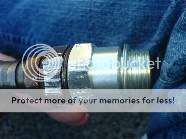

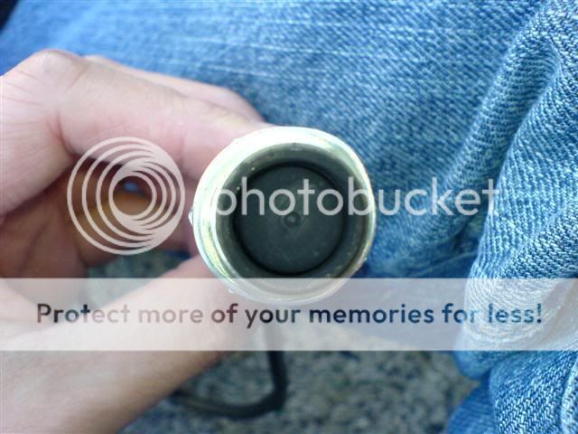

So what I've been able to learn so far is that the O2 sensor has a heater in it that is supposed to heat up the sensor faster so the the engine can run in closed loop mode. I removed the non-fouler closest to the header because I thought having the sensor closer to the exhaust stream might make it heat up fast enough, but I still have the same P1141 code (but at least I still don't have the excessive flow code).
From the manual it looks like terminals C and D on the plug are supposed to have a resistence of 15.7 ohms (at least that it what it's supposed to be on the FS engine), that there is a positive voltage from terminal C and that terminal D has continuity to the ground. I'm going to try checking it tomorrow. Hopefully the PB blaster I got on the sensor when trying to remove it didn't mess it up! I know I didn't overtwist the wires.
Pulling the O2 sensor in:
I'm surprised the computer doesn't tell you "no airflow":
Anyone know if there is a way to clean the O2 sensor?
