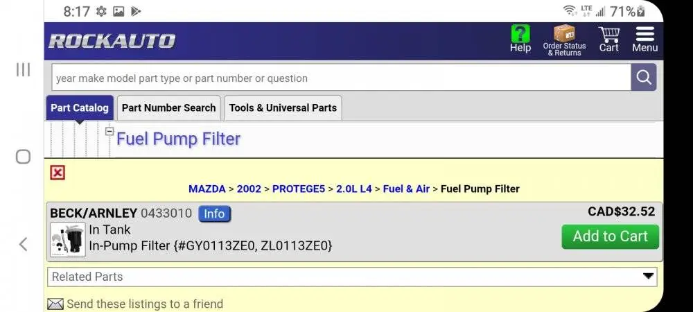

Now I gotta add that to the list for the son's P5 while I'm waiting on crap parts sent back and returning from eBay.

Replacing the fuel filter is a lot cheaper than waiting for it to fail, and having to replace the entire fuel sending unit...
It's about $25 US.
The entire fuel sending unit is a lot more money...
