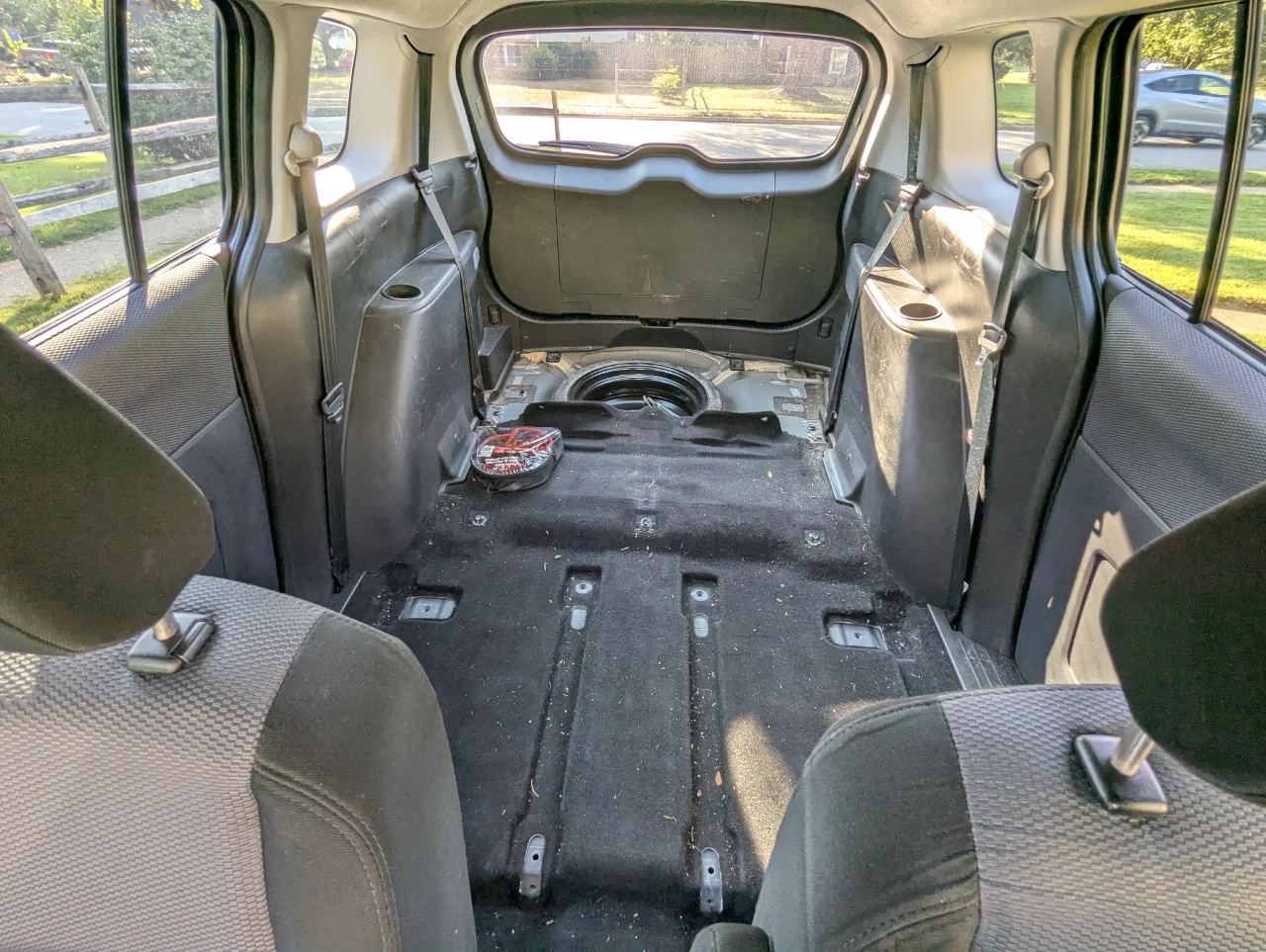

The cavern! Barely any difference... basically felt fine, empty or with 850# load. 🤷‍♂️ If anything it had less roll and behaved better at highway speeds.
