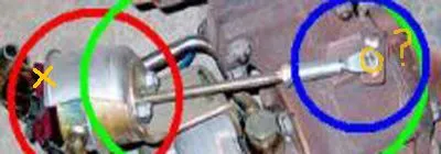

alright well can't do this mod at school but seems legit so its possibly i'll try it when i get home. anyways, I wanted to make sure i knew what ends the springs attach to so can someone tell me if this is right, i had trouble figuring out from the pictures. i marked the spots i was thinking it was with and orange x and an orange circle
Yup, that's it.
