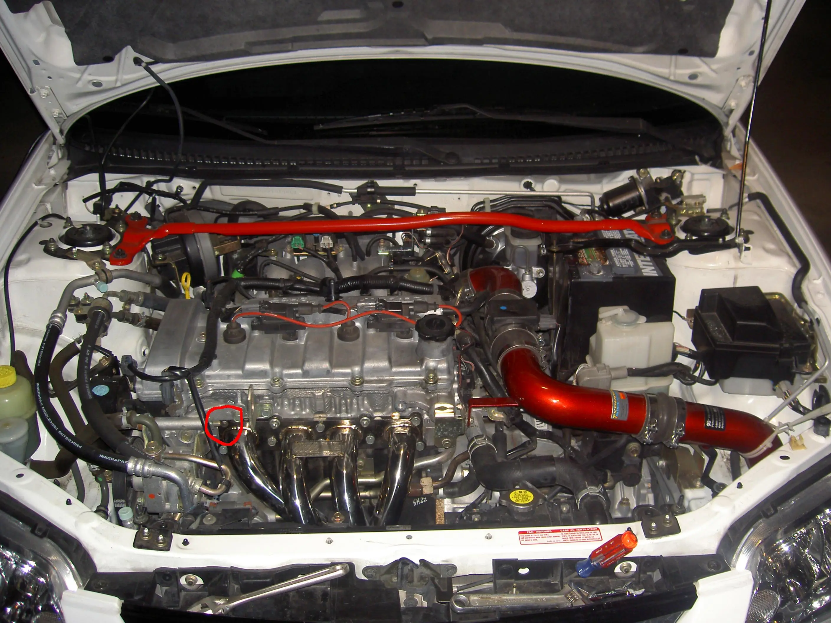

I'll try that with the EGR. Here's a pic of how far it's off. It's not much, but no amount of prying/heating would allow it to line up.
As far as snapping a bolt off in the head, what do you suggest? I used my torque wrench set to 15 ft/lbs just like i did with all the other bolts, but this one snapped right off about 3 treads from the head of the bolt. Whats really comfusing to me is that they are all grade 8 bolts, they shouldn't snap that easily. How do I get it out? Here's a pic:
Woo Hoo! I finally got the EGR pipe to connect, I had to heat the pipe up at the bend near the TB and pull it out to give me that extra 0.5" I needed.
It sounds so good and drives so nice. I love the extra power and improved throttle response. The butt dyno tells me I have arounf 5 extra hp.
Has anyone dynoed their car before and after header install to see the gains made?
