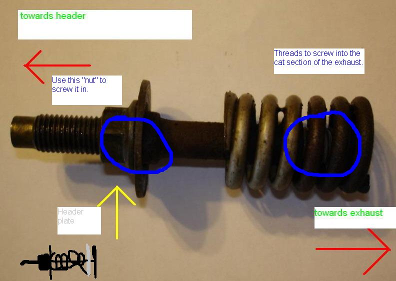

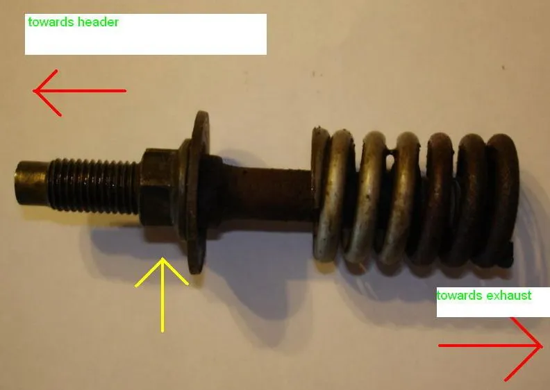

did i break this bolt? When i was trying to undo it, i heard a loud SNAP! then it came off. and where the yellow arrow is, was it just that nut suppose to come off? or the whole thing you see here?
thanks
thanks
NO! It is perfectly fine! Trust me, I have had more problems with that bolt than anyone. I know that bolt like the back of my hand. Speaking of which, I still need to get my second bolt from Mazda. Only running on 1 now :D. Anyway, no its not broken, under the spring (looking at the pic) there should be a threaded end. Screw that back in to the cat section and have the spring what looks like a nut and washer on the other side of the header.
yeah its a pain in the ass to compress the spring while trying to screw the bolt back on though.
yea and I've swapped out my exhaust like 3 times now :p
PITA every time

I managed to get the other one off without taking out the whole stud. if the nut and washer come off only, it's so much easier to get back on.
I had to use an impact to get the other one on because i couldn't compress the spring.

woa wait that bolt? its completely broken
i had to dremel mine off cuz i complete stripped that nut facing toward the headers so its connected with only 1 bolt (just went and bought a new nut washer and bolt)
but bolt it sucha b**** its like double sided basically, u broke it rite in the middle
