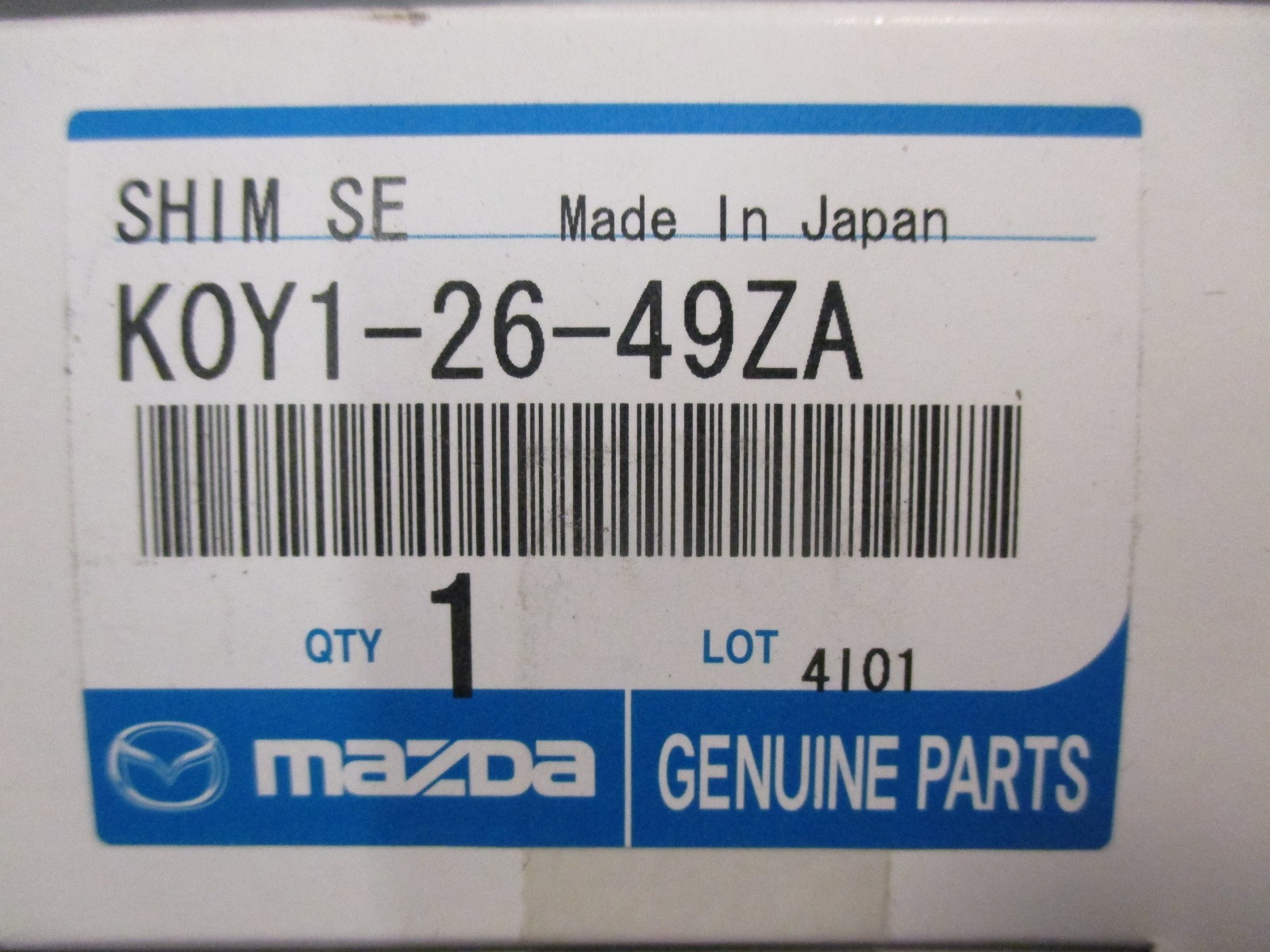

I'm gonna throw a new hardware kit on the rear as well. OEM only about $14
PN: K0Y12649ZA ('13-'15)
Great idea! I've found that the hardware keeps the brakes from squeaking and sliding around. I learned from experience that the hardware is only good per each set, or else the stuff gets loose.
Does this shim kit include 2 different type of brake greases in the background?
On Honda the OEM brake pad kits do include these shims and brake grease. And your Mazda OEM rear brake pad kit doesn't include any of these?
The OEM pads I bought came with those two. I'll let you know tomorrow when the shim kit arrives if that also includes them.
Then what is the purpose of getting this extra shim kit?
Good point...Yeah.. I wouldn't use an open end wrench either. I was thinking more of general guidance for the non EPB first gen models.
Then what is the purpose of getting this extra shim set?
I didn't purchase the shim kit for the lubricants. I just wanted to replace all aspects of the rear brake hardware. If all for naught a waste of less than $15 which won't likely make things worse.
I see. Normally OEM brake pad kit will include everything needed, including brake grease, to be replaced as outlined in the Service Manual. That's why I always get OEM kit. Please let us know what are the additional pieces in the shim kit not included in your OEM brake pad kit.

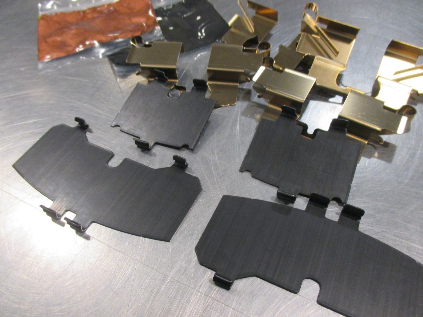

I swapped my pads and shims this morning. The hardware came with greases as well. Make sure the spring piece of hardware shim is compressed enough because I didn't do that the first time and wear indicator popped off one of the pads. Easy enough to put back on though. I just took my time. Jacked up by the rear differential, jack stands on each side, tires under for extra safety and chocked front wheels on both sides.
So the only item in your hardware skim kit K0Y12649ZA not included in your OEM brake pad kit is the metal spring piece?
Everything here was included in the hardware kit.
The only redundant items with brake pads were the brown and black grease packets. Just pads and grease. Nothing else pictured above came with pads.
