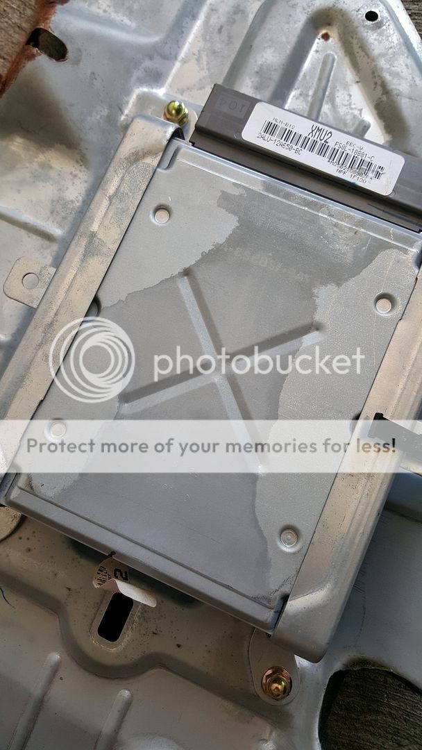

Update: Went and got a MT Ecu from a 2.0 protege.
Took a few cranks after resetting the ecu for it to fix itself. But it has a terrible idle issue. Which would cause it to jump to 100rpm, turn on the dash lights real quick, then fix itself.
