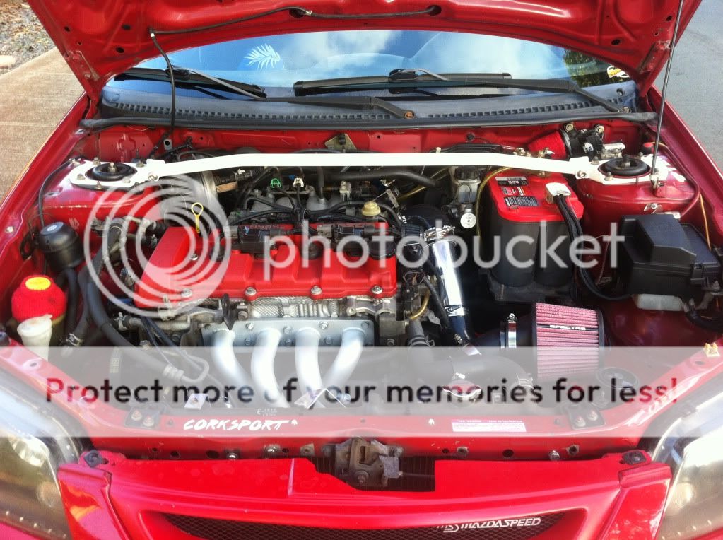

Got the new piping routed. Need to paint the pipes. Other than that everything is good.
EDIT
Damn that looks sooooo clean, Cres. And your strut bar looks good white. I think I'll paint mine too. But are you missing your battery tie down?
ps- thank you for finally posting pics.
