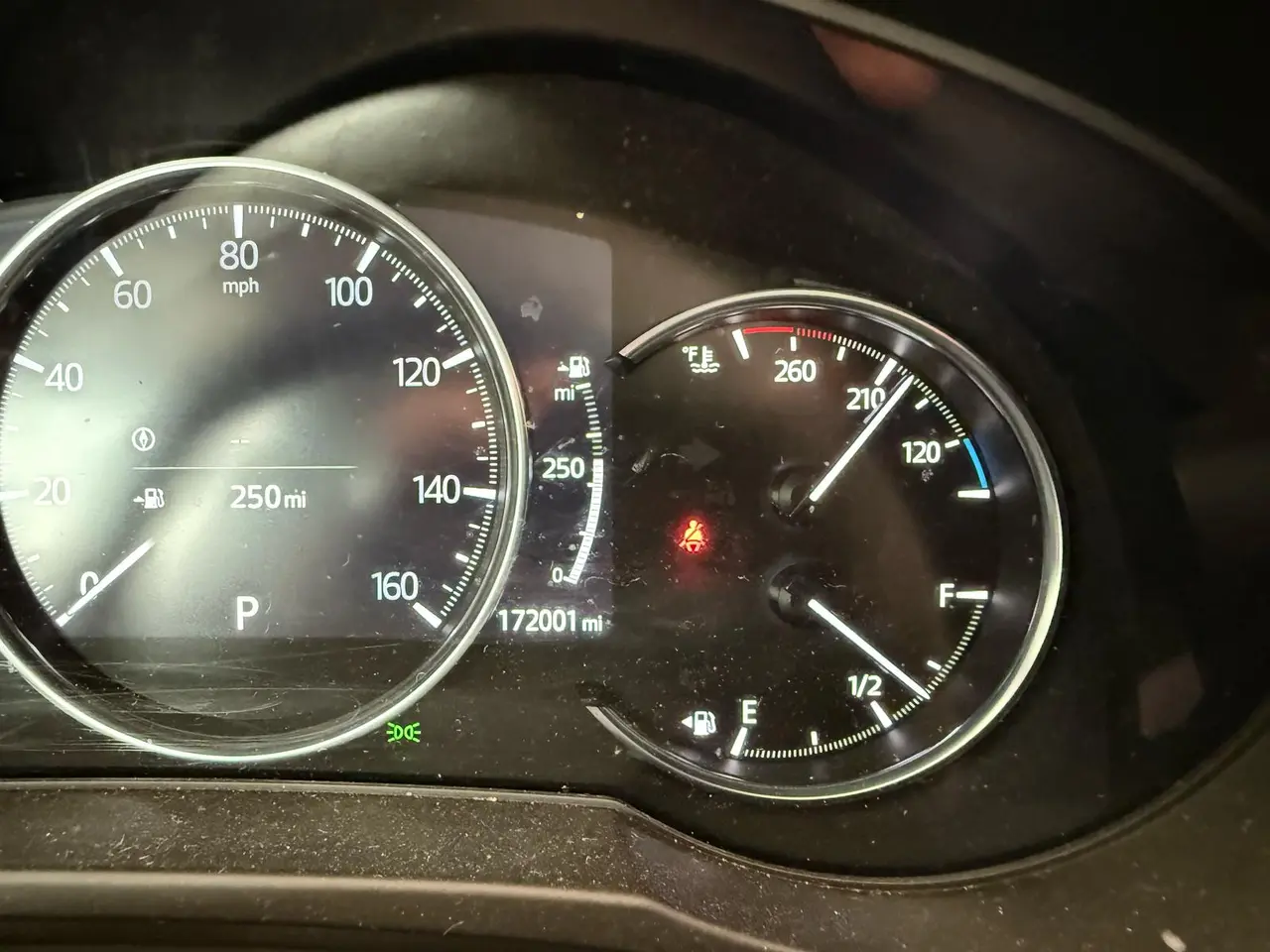

Just passed 172.000 miles (276.809 km) with my current 2020 CX-5.
