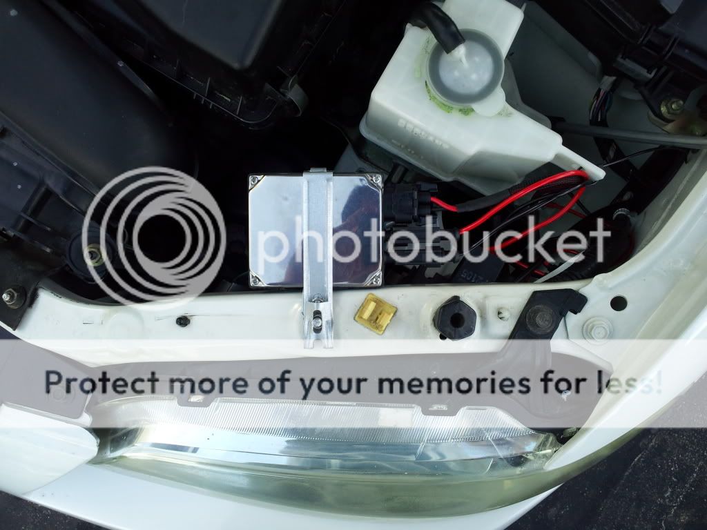

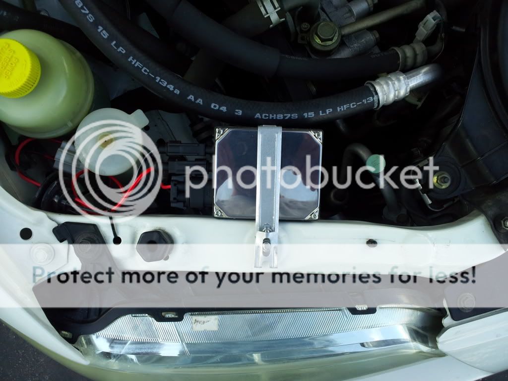

Hey guys. I am bringing this thread back to life. I figured out a good place to mount the ballasts. If you need step by step instruction let me know. I have one problem and I am hoping someone can help me. I put in the bulbs and the white strip is on the top but it is still had to see at night. I don't really see the light on the ground in front of me when I turn on the lights at night. It seems like the light is shinning too high and not hitting the floor but I followed the directions and I place the light bulb correctly in the headlight and used the clip to hold it into place. Any thoughts on by the light might be shinning too high up? I have 6000k and from what I have read those are suppose to be nice and bright.
Anyway.. Here are the pics
Have you tried turning the adjustment knobs on the back of the headlight assemblies?
NOPE! How do I do that? ... I am editing this to say that I used my computer skills to google how to do the adjustment. I will try it later tonight.

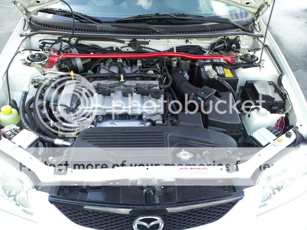

I did mine like this............probably leave them in same place when I switch in the sedan housings and go with H4 HIDs from my truck.
