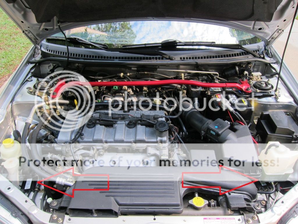

Has anyone else had significant radio interference from the ballasts? I have mine on the inner fender and I get a lot of radio interference, even with ferrite cores between the igniter and the bulb. I'm using the Morimoto H1 kit with 35W Morimoto XB ballasts.
I've had my DDM slim ballasts for about five years now and never had any radio interference. They're located with red arrows:
