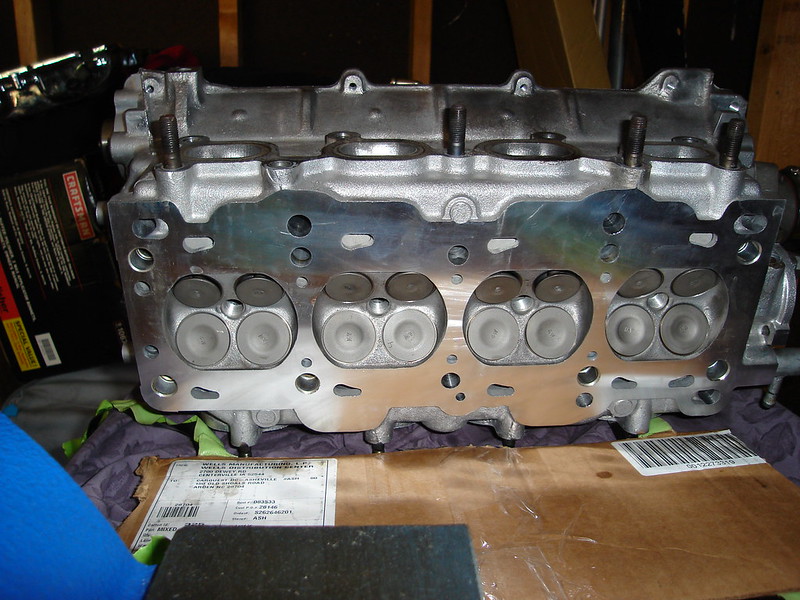

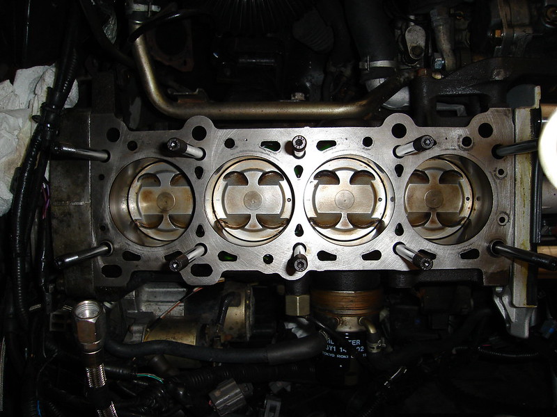

Cylinder head got installed and torqued. Couple of times I thought I was going to break those ARP studs! Did a lot more associated with the head, here's some pictures:

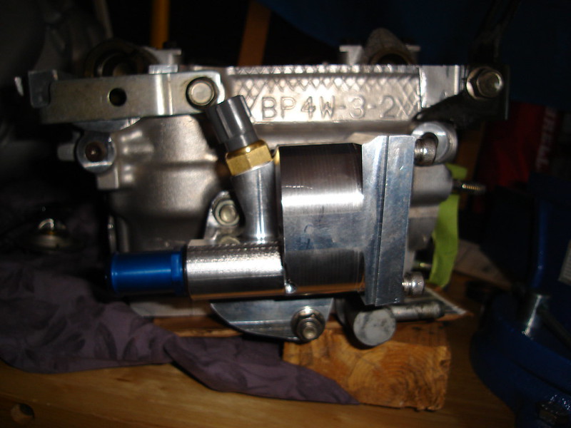

Here's my new reroute spacer, had some trouble getting the upper nut tight due to lack of clearance as machined.
What I did that day (besides the obvious) was to measure the thickness of all valve shims, assemble the cams to the head and check valve clearance. That then allowed me to determine what shims I would need to correct lash. I ended up needing four, unfortunately I made it to the dealer a little too late for their ordering so I wouldn't get the new shims until Monday. I had 10 clearances that were out, a couple were very tight. Cleaned up the block seating surface as well as the pistons. I couldn't find a large sanding block anywhere in town so I bought some belt sander refills and cut a piece of 1 X 4 board to allow me to use that as a sanding block. It worked pretty well.
The picture above showing the block/pistons is after I sanded the gasket surface.

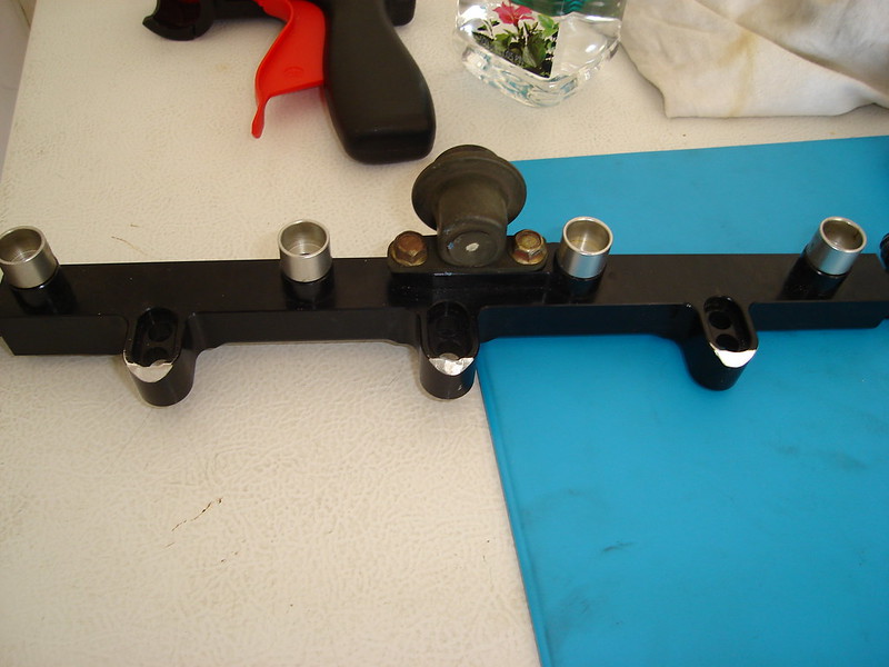

Got the intake side buttoned up. Modified the M-Tuned fuel rail so that I can get the valve cover on and off easier, this consisted of beveling three areas where the bolts pass through. Used new insulators for the injectors where they go into the head. Ground down the thermostat to fit the new spacer and finished making the gasket needed so that is all closed up. Cleaned up and painted the JR header. I thought I got all the peanuts blown out of the inside, I ran my fish tape through it before bolting it up just to make sure.
Fuel rail mod:

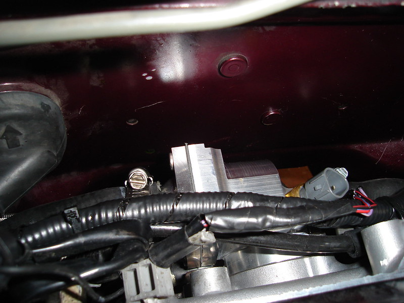

Reroute spacer firewall clearance (I know, kind of hard to see but it's more than with the BEGi spacer):

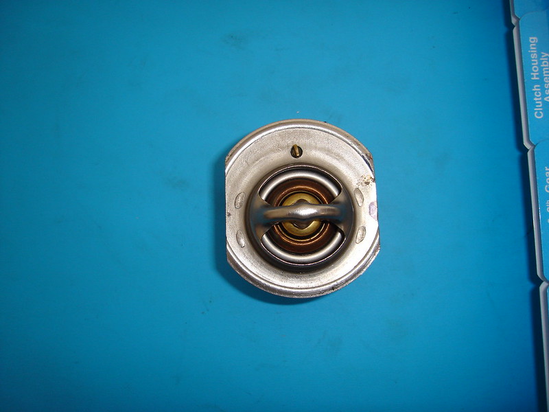

Modified thermostat:

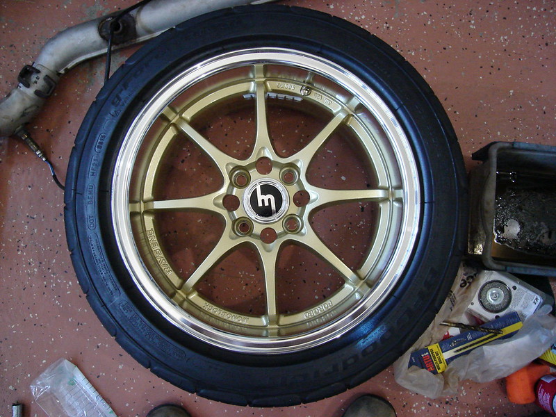

Finally got a small side project finished up, although it looks like I'll have to repaint it once I get some more spray as I've already gotten some chips:
Beginning:
Finish:

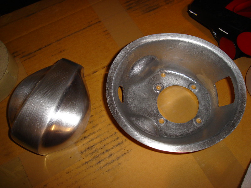

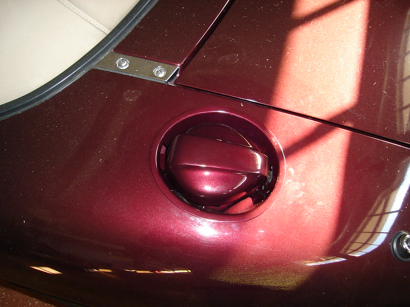

As I've said before I'm not a blingy type, while I liked the Zoom lid I didn't want all the polished metal shining at me. Someone said, why not paint it? Why not, indeed.

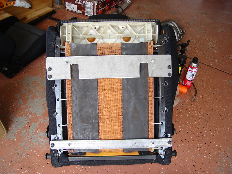

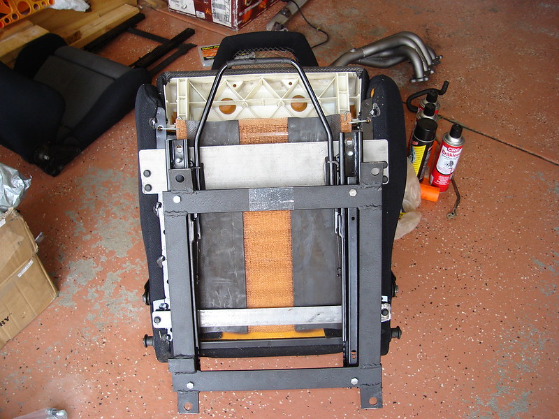

Got the driver's Recaro installed, and it fits just the way I had hoped. All that's left is to attach the seat belt receiver, I have an idea about that.
Since doing this I have given it more thought and decided it might be better to run the adapter brackets fore and aft instead of across. However I am going to wait and see the quality of the Wedge Engineering brackets I bought to mount similar Recaros in my RX-7. If they are good then I will probably just get a set for the Miata and sell these Corbeaus.

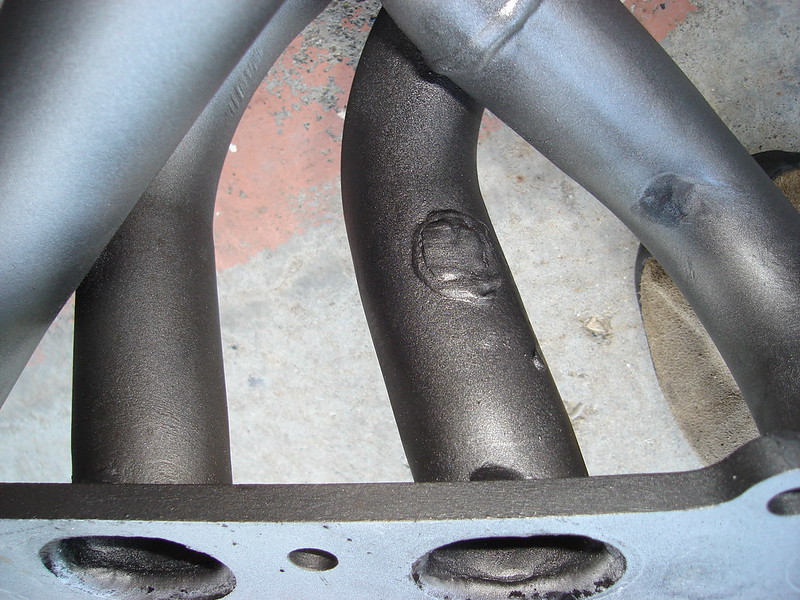

Dropped my JR header off at the local welding place, they cropped off the EGR tube completely as well as moving the O2 bung I'll be using for my wideband. Whoever put it on in the first place had it sitting at about the 11 o-clock position and with the MTX-L I'm using, the wire coming out of the unit would be rubbing on the tranny tunnel.
Header was picked up and I painted the disturbed areas. Also painted the seat brackets. The next morning I got both seats installed, everything fitted and worked except for the back release levers (due to interference with the seat belt receivers) but I don't need that anyway. Header was installed and torqued down, thank heavens for ratcheting wrenches as two of the bottom nuts are about impossible to tighten due to clearance issues with tubing. Moved valve shims around based on the readings I took previously, however when I measured the clearance after that some of them were still out of whack. They had to be done again. The rest of the day was spent removing shingles from the roof for installation of a new roof (had to keep the wife happy).
Ordered the rest of the shims I needed. Here's pictures of the header modifications:
EGR removal:
O2 bung shift:

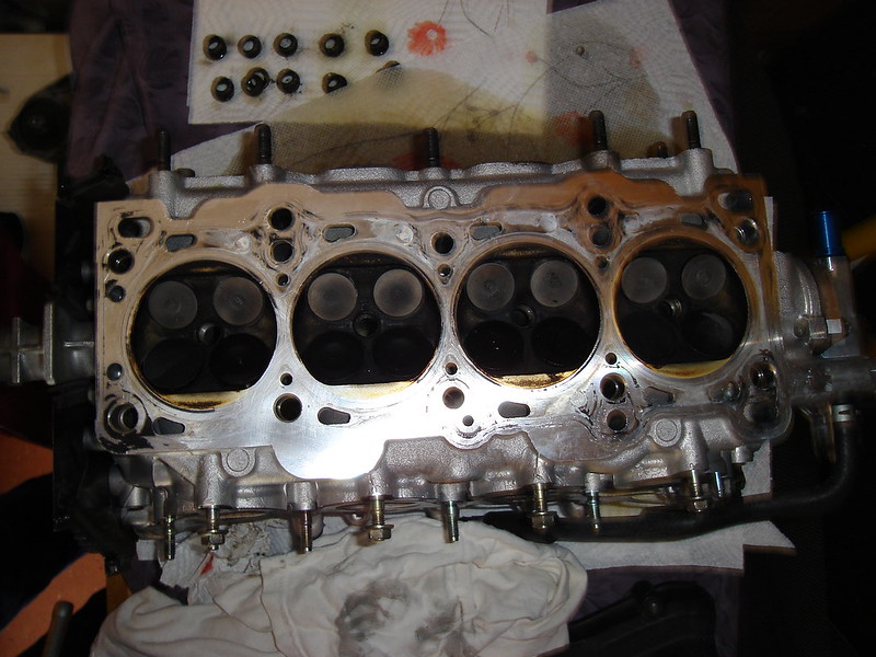

Out driving on another day and started getting a stutter again. Pulled the plugs, coolant in #4 cylinder. !@#!#$)$^)*&)#$^^&&)@$*@@!!!!!! I have no idea why it was, car was fine, no overheating or anything else that would cause a problem, now this.

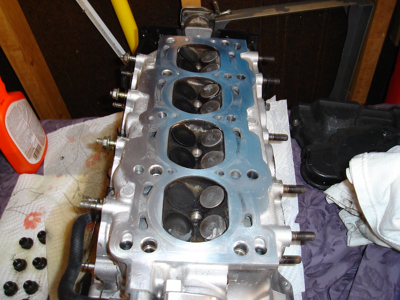

Three hours and fifteen minutes to pull the head off. Looked fine with no apparent warpage. The only thing I can think of is the slightly uneven tightening I did due to that little bit of wiring that got trapped at the rear. If that was it, then it means the MLS gaskets can absolutely not be compressed more than once. I'm going to try cleaning the head up with some aluminum polish I saw at Ace, ordering the gasket in the morning.
Helpful tip, an easy way to remove hard-to-reach washers is to use a magnet. My fingers are somewhat long and slender, but just won't reach into the head very well.
Got the head gasket ordered, it was due in a couple of days. Cleaned up the head and block surfaces, due for a root canal the next day so I doubted I'd feel like doing much. Replaced the studs/nuts holding the reroute spacer on with socket head cap screws, I couldn't get the one nut tight enough to make me happy due to the machining which restricted access to it. I had put the bottom nuts for the intake manifold on the head so they wouldn't get lost, as I was cleaned it up I noticed one was missing. Looked all over for the damn thing and couldn't find it, right before I came in I moved the head slightly and heard a clink. There it was! Still have no idea where it was hiding.
Pictures of the head before/after cleaning:
