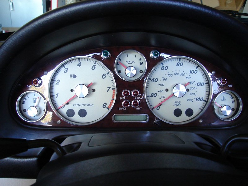

The KG Works gauge panel had finally arrived while I was gone, so that went in along with the needle caps. I also replaced the gauge hood and combination switch.

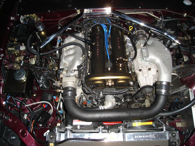

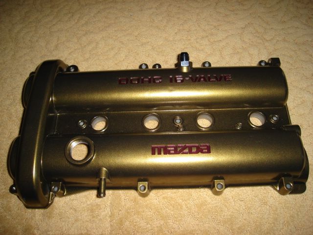

I had bought a spare valve cover somewhere along the way and sent if off for powdercoating. After some consideration I decided to get a catch can setup from the same guy. He put an AN fitting in the valve cover and I got some black hose and fittings to complete my connections. That all showed up looking just fine:
As you can see, I painted the lettering on the cover Mahogany Mica. I think it gives it a nice understated look which is what I like. My wife asked what was in the big box when the cover showed up, when I showed her she asked where it went. When I told her under the hood, she said, who cares? If you need any evidence of the difference in how men (gearheads) view cars versus (most) women, look no further.

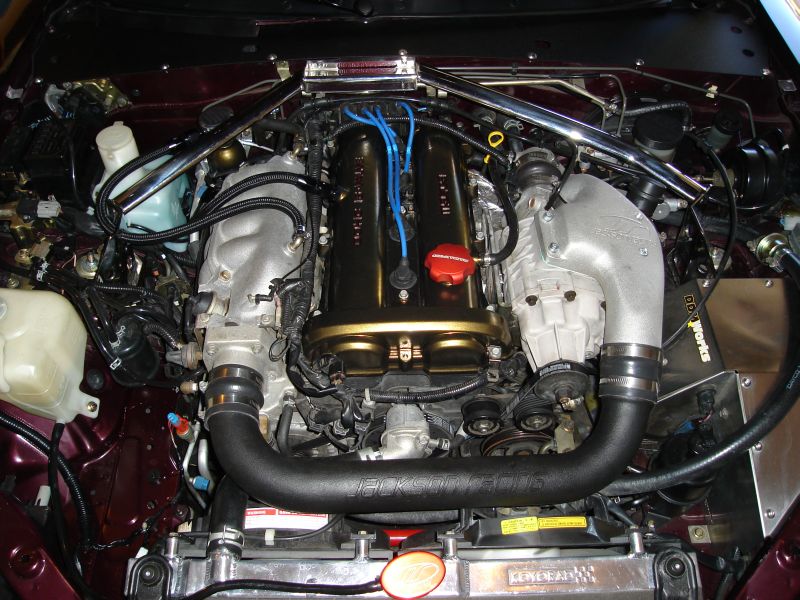

And here is how it all looked installed (valve cover, catch can, wiper cowl):
If you look closely you can see where the catch can was mounted at the rear on the passenger side. It turned out I mounted it too low and it started leaking from the drain valve on the bottom from being vibrated against the body. Even though it was my fault, the guy who I bought it from had me send it back and he replaced the drain valve with a 90 degree fitting. While I was waiting for it to come back, I scored a NoPro washer bottle from eBay for $50. Installing that gave me more room to play with in the back corner, so the catch can mounting was modified accordingly. Note that the new washer bottle was installed as has been noted elsewhere, I extended the wiring harness and reversed the way the discharge hose was routed to the nozzles.

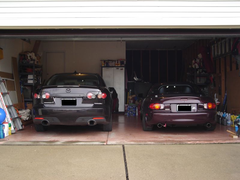

Here's a picture of her next to her (then) big sister:

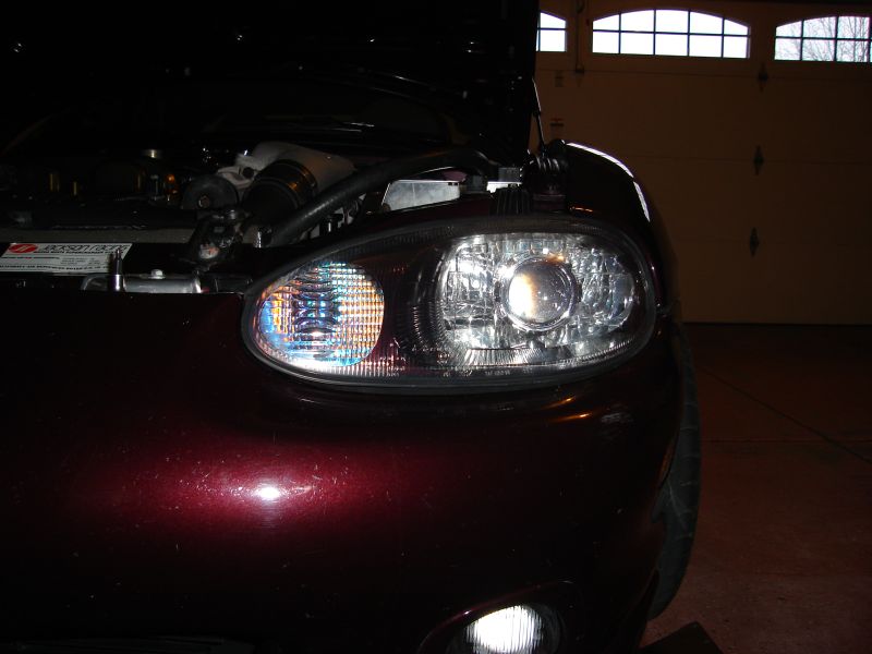

Received my HID order so set about getting that done. I got lucky enough to pick up another set of headlights so those went on the car while I worked on the stockers. Did the bake and disassemble thing (with no grief about using the oven). I painted the outer chrome trim pieces body color, I used blue painter's tape to mask off the areas (like the turn signal recess) that I was going to leave chrome. When I removed the tape it pulled some of the chrome off with it, so much for it not sticking to things. I ended up solving that issue with a small brush and some model paint. Removed the orange cup off the turn signal so I could use one of those lights that doesn't look amber until it lights up. With the complete kit, installation of the projectors was very easy. Got the headlights all buttoned back up and then put the ballasts and wiring in. This was pretty basic stuff, I did find a door on the outside of the fuse box (you have to remove the fuse box to get to it) that has a 10mm head bolt underneath holding the power supply cable on. That was where I tied into the power connection for the lights. Ground went in the same area. Got everything all done and tried the lights out. Success! Well, almost. I only had low beams. Back to research, found out the Miata has a ground switched system so I needed to swap two of the wires on the connector plugged into the headlight socket. Did that and promptly blew the fuses for the headlights. Then started a long process of going back and forth, researching and trying different wire connection configurations with no luck. I would have either lows, highs or blow the fuses. Finally called TRS, and they said they had a new harness setup that should take care of the problem. We arranged for them to swap the harness with the one I had (I think I only had to pay shipping and maybe a couple of dollars more for the difference). I got the new harness and put it on, nice bright lights were now mine. If you order one of their kits now you will receive the updated harness so shouldn't have the problem I did. I can recommend TRS, they are another good vendor with great customer service. They have a very good forum too with lots of info on HID upgrades.
Here is a small shot of one headlight as finished:
I know a lot of people paint the reflector as well, but I wanted something that looked just a little out of the usual. If I change my mind I can always pull them back apart and paint the rest. I really like how it looks from the side now, but I have somehow not taken any pictures from that angle (shocking for me, I know!).

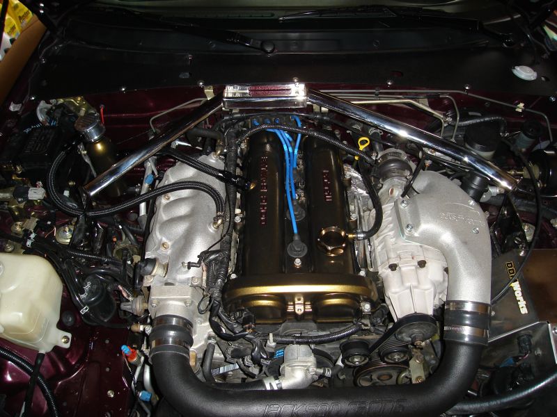

Here is a picture of everything in place including the coolant tank (note this was before I switched back to the other valve cover). You can also see the final position of the catch can:

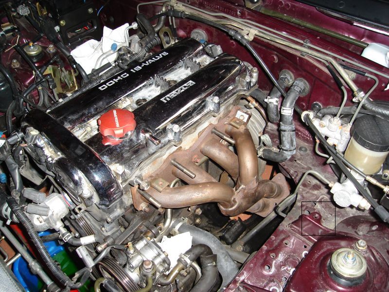

If you look just above the shock mount you should see a black box around the bracket that was causing the noise. I had already put touch-up paint on it when I took this picture. So for anyone with an NB and a M45 supercharger, if you get an annoying buzzing look there first.
Also removed the DDM Works CAI box, both radiator fans, upper intake manifold and stock fuel rail. Note that I bled the pressure off the fuel system first by pulling the fuel pump relay under the steering column and then running the car until it died (which didn't take very long). The stock fuel rail is pretty dinky compared to the M-Tuned piece. I had some trouble getting the stock fuel supply hose off, the manual showed it having a replaceable locking piece but mine didn't, there was just an orange colored locking piece. I ended up using a couple of jeweler's screwdrivers and some colorful language to get it off.
