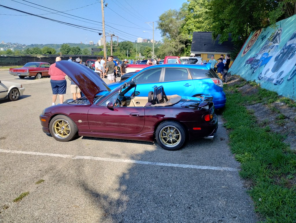

Yesterday I went to two Cars & Coffee events. When leaving the first one, I smelled gas strongly. I then noticed that my gas gauge was dropping a lot quicker than it should be. Had a look around at the second stop but nothing appeared. Headed for home after that to the same gas smell and gauge movement. Once in the garage (and shade) I took another look around. It appears that I may have a leak from at least one injector O-ring so the top of the intake manifold and the fuel rail will be coming off. I’ll also hoist her into the air and check the hoses for the fuel filter (didn’t see any leaks from there but want to be thorough).

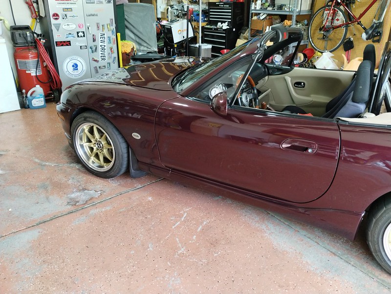

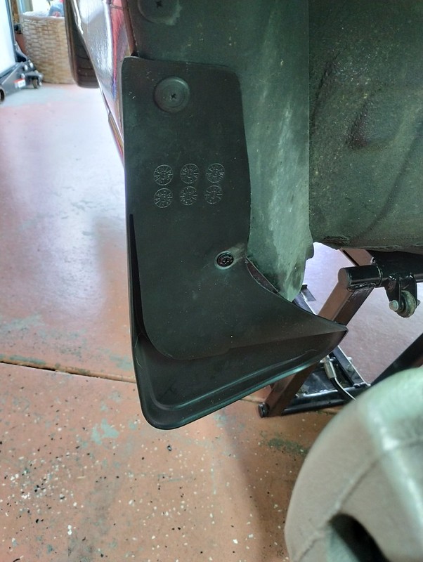

Next up I installed the generic front mud guards I bought a while back. I used two of the existing fastener locations for this. I replaced the lower screws with ones from the guards. For the first one I tried making a template to locate the holes but that didn’t turn out as well as I had hoped. I just winged it for the second one and it came out better. I will note that there is a recess in the front of the side skirt for the bottom screw, I used washers to take up that distance so the screw had a solid backing. Here are pictures to show how that looks:
At this point I only need to adjust the rear brakes and give her a good bath/waxing to be ready for MATG. Here’s a glamor shot from C&C on Saturday:

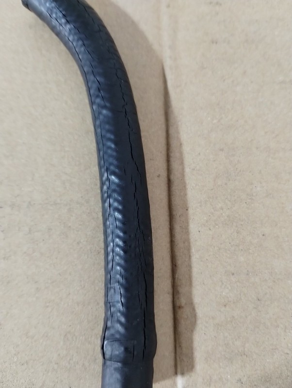

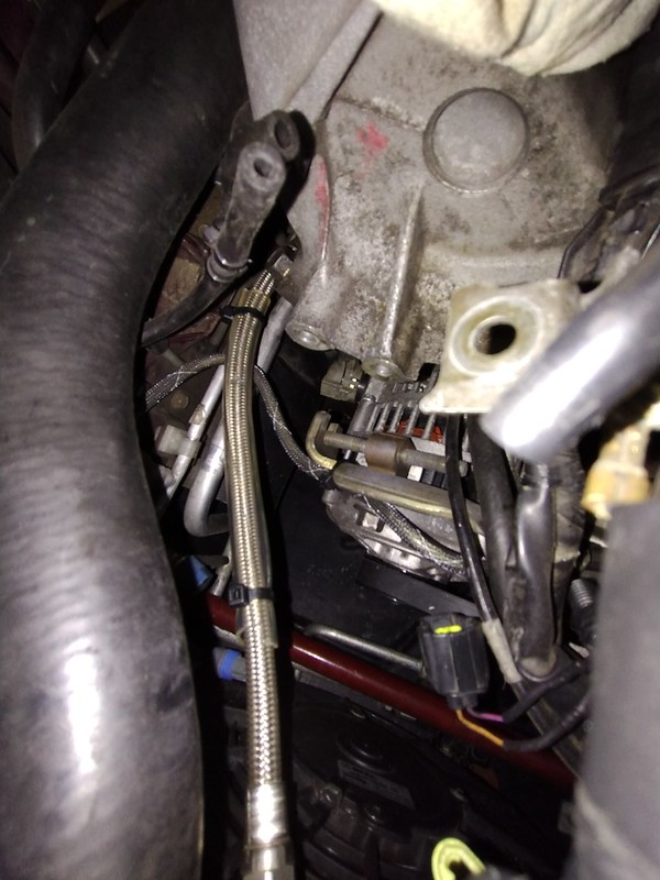

So, it turned out that my problem with gas smell and dropping of the gas gauge was still evident after changing the injector seals. Next possibility was broken injectors. I went ahead and ordered some new ones but chances are they won’t show before I was planning on leaving for MATG. I have a set of Denso 550cc injectors I used before when sending off my EV14s for work, so I dug those out and set about installing them. Got those put in, when I fired her up there was at least one of those that was spewing fuel out of the side of the injector body. I suspect it was blocked. Didn’t look to see if any of the others were the same, I just shut her down. Not having any other options, I decided to put the EV14s back in.
While doing this I noticed the short rubber fuel hose connecting the hard line coming from the fuel pump to the braided stainless hoses to the fuel rail inlet was badly cracked. You can see that here:
Was this the cause of the fuel smell? Only one way to find out, I replaced it. Once the EV14s were back in and with the new fuel hose I fired her up. Everything looked good so went for a test drive. There was a little fuel smell (likely due to all the fuel that came out of the rail while changing the injectors back and forth) but nothing like the intensity from before. I also did not see the gas gauge drop as it had been doing when I got on it. For now I’ll call that a win.
I am left with wondering why if the hose was the cause of all this that I didn’t see any signs of fuel being sprayed around the engine bay. Something I will have to keep an eye on.
May it was just weaping? Does take much gas to stink up the place.
I understand that, but that wouldn't explain the rapid dropping of the gas gauge.

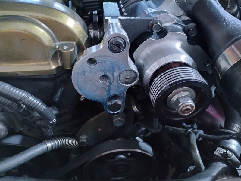

After I had the ‘charger oil leak I noticed that I was only building 5psi (about half of normal). Figure the most likely culprit for that was belt slippage. Just picked up a new belt to replace that, I need to clean the pulleys and everything else before installing it. I pulled the tensioner assembly, as can be seen that oil got everywhere:

Yesterday I cleaned everything up, got a new belt for the ‘charger and installed it. Ran to storage to change back to the NB seats, discovered I still am only building about 50% boost so the belt wasn’t the problem. When I got home I looked at my boost pipe connections and all were tight. I then tried moving the bypass actuator using my MityVac. While it did move it wasn’t smooth. Track Dog Racing says these last about 30,000 miles (and 2-3 years), I have about that mileage on it and a lot more years so I ordered a replacement.

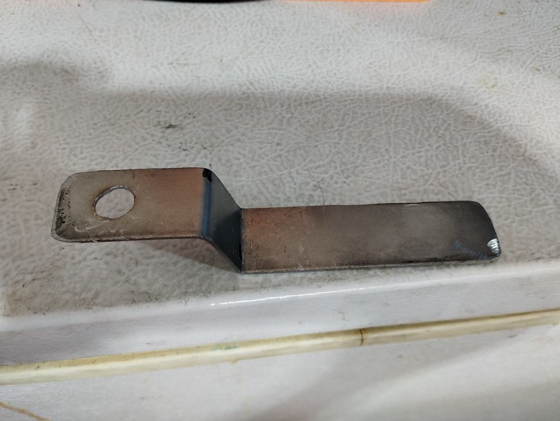

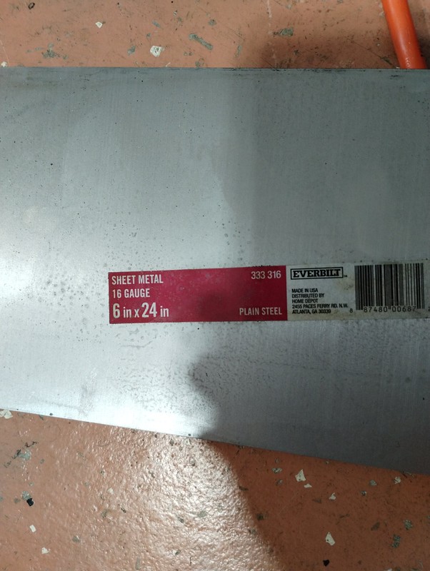

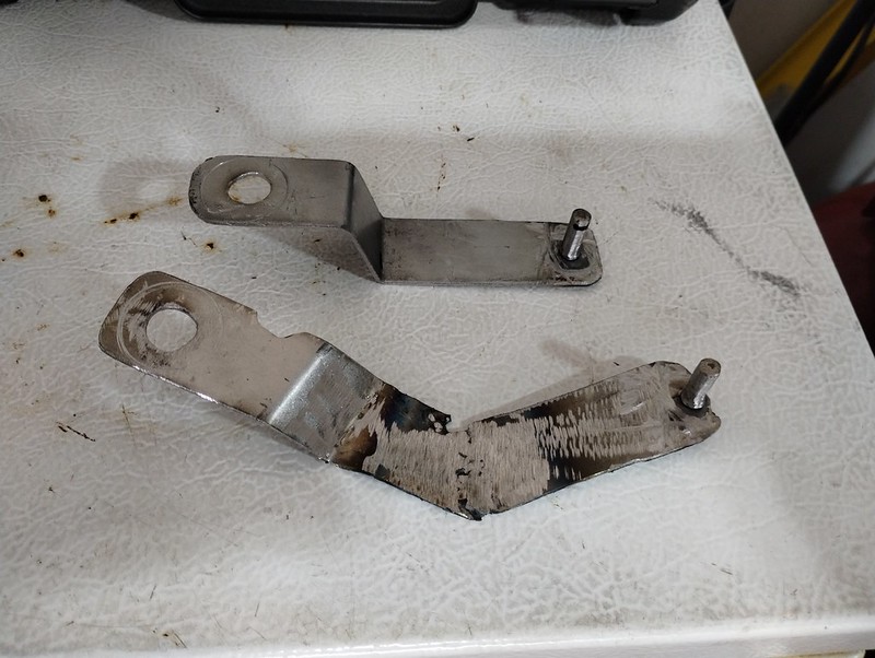

I have been thinking for a long time about fabricating some sort of bracket to hold the driver’s side floor mat in place. Looking at the wear on the old mat I think it moving around has contributed to that problem. I would prefer not to damage my newish mats in the same way once I get the rust stains cleaned off. I don’t like Mazda’s solution of having big plastic screws into the carpet. So, I swung by Home Depot and picked up a piece of this:
I also got a piece of 3/16” steel round stock. I ended up cutting off a 1” strip from the sheet. After some judicious bending, measuring and drilling a hole for the seat bolt (also had to Dremel file it a little bigger followed by some hand filing to dress it up) I ended up with this:
After checking the hole in the mat I think I will be better off with 1/4” round stock for the pin so will head out tomorrow to get that. I will then make another bracket for the inner hole in the mat, get the locating pins welded in place and paint it up. Pictures to follow of the finished product.
Got back on the brackets today. The right one ended up being something of a pain due to needing to have it angled. I scrapped the first one I had made. Got the second one to where I thought it would work. When welding the two pieces together I tacked it first and it looked good, then proceeded to run a full weld. That didn’t happen, midweld I heard the one piece hit the floor so I had to redo that weld. It wasn’t pretty when done but it holds nicely. Here a picture of the finished brackets:

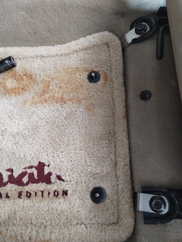

Here is how they look when installed doing their job:
I had to grind down the pins’ outside diameter so the mat would fit nicely without movement. I shot them with some semi-gloss black paint, once dry I’ll fit them for good. I am going to see if I can find some flanged bolts slightly longer for those two front seat bolts just to be sure I have plenty of thread engagement with the brackets in place.
