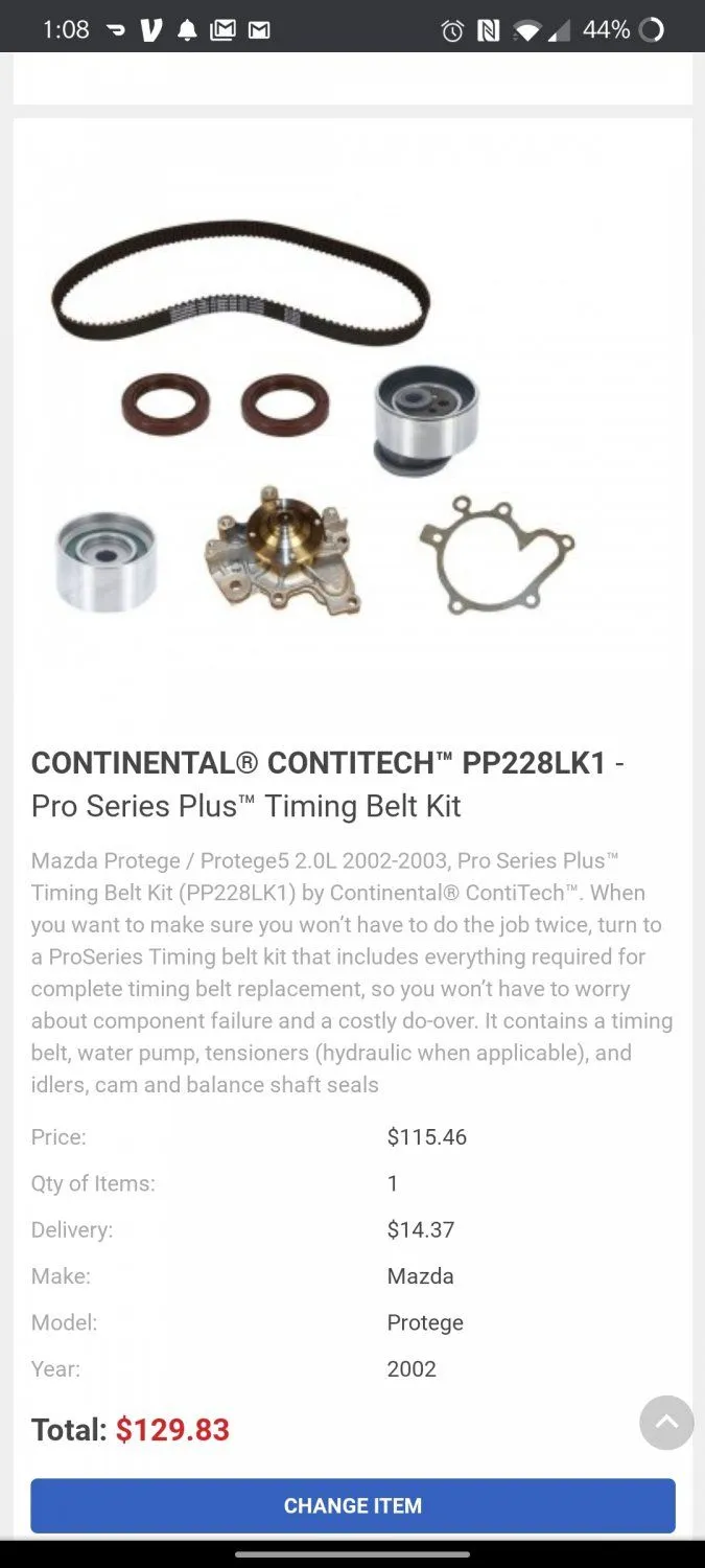

I just ordered valve cover gasket and timing belt kit. Hopefully I'll be able to handle that one okay with my degree in YouTube mechanics.
Here's a How-To for replacing the timing belt.
Awesome thanks a lot man, I've been watching all the protege 2.0L timing belt videos. This will be helpful
Don't forget to replace your water pump while you're in there if it didn't come with your kit and your accessory belts too. (They're cheap)
I paid ~$400 CAD for all the parts.
I was quoted $1600 at the shop. (not including the water pump or accessory belts.)

I hope it had the spring for the idler pulley.
You should think about the water pump and belts too.
EDIT... Yeah, I see the water pump now...
Also, you might want to skip the seals.
They're difficult to install and some guys have to replace them yearly now because they keep leaking.
If they're not broken don't fix them.

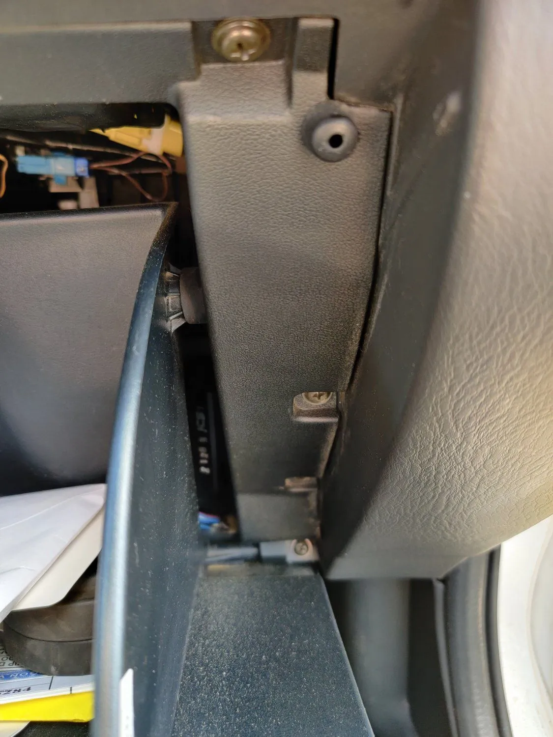

Is it these two screws on either side to remove the glove boxs and some wires possibly need to be disconnected?
