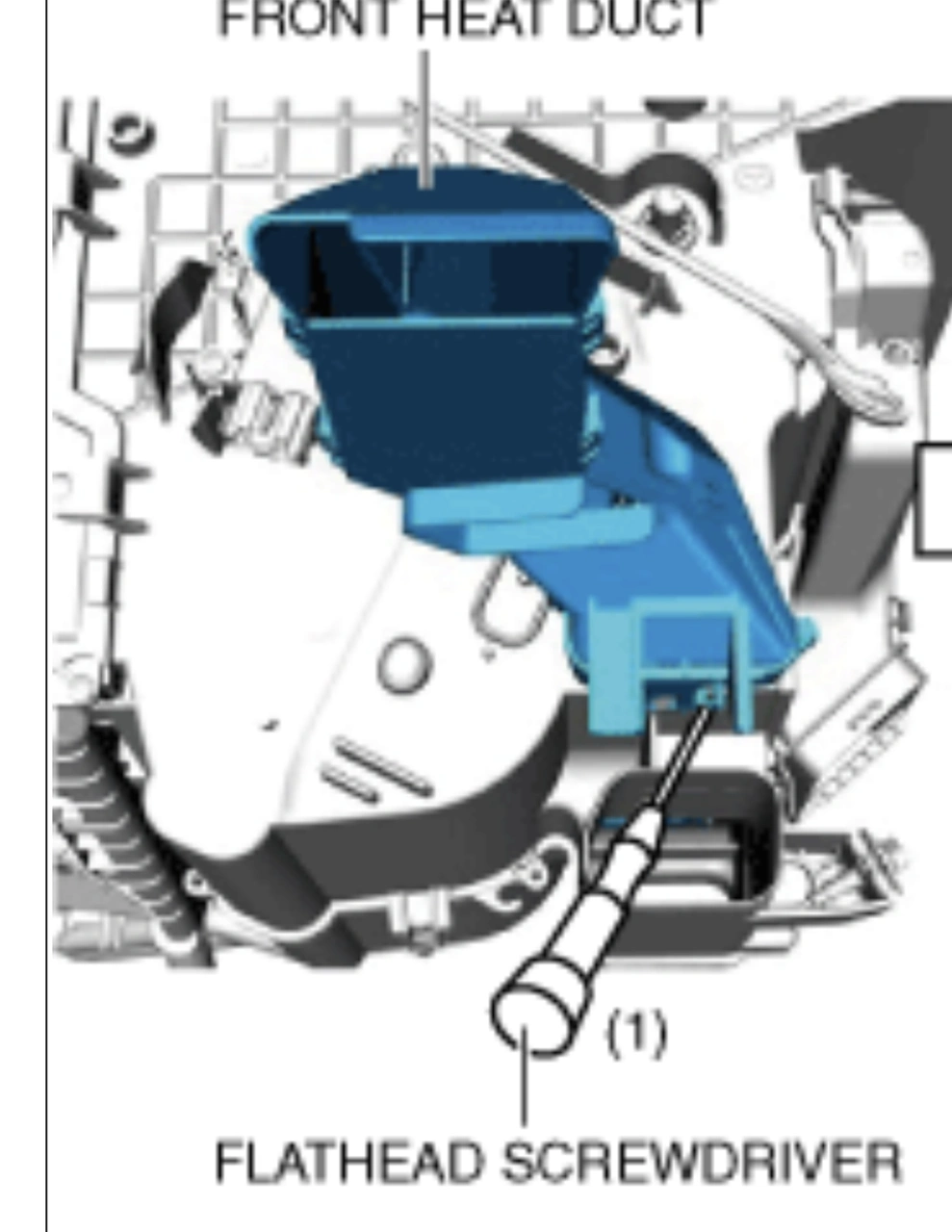

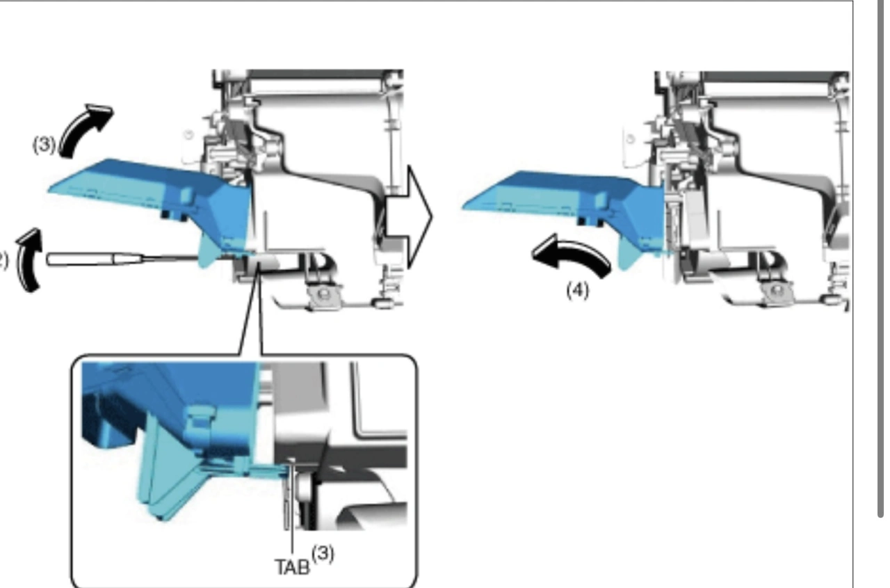

Yes. There is a tab.
Insert flathead screwdriver and lift it up (at the handle side) to push/detach the tab. The lift up and out the duct to remove.
Hi cz5gt, my charging equipment for R-134A reports that 40psi at 25 deg.C (my measurement ambient) is mid acceptable range. I had disengaged that tab and the duct would not budge which led to my help request.
Thanks cz5gt! Those pics align with what I thought would work but no joy. I found actual duct photos on eBay and see there is a second hidden tab at the top. I'm going to make a tool to depress it and give it another go.
May be try to twist the duct up (as in 3. above) to see if it will disengage it. It could be the upper tab is just a "holder".

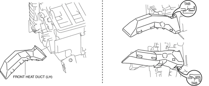

Hi cz5gt, just found this pic which shows the hidden tab. This design could prevent the upward pivot/rotation.
based on this design shown, the upper tab should unlock automatically when the vent is tilted (after unlocking the bottom one).
But if it doesnt its either stuck or needs more lifting force to push the upper tab. Strange that it doesnt move.
Sometimes when these plastics were never removed they get sticky. Wiggle it a lot.
Dont be afraid to break it. It can be glued with special glue for car plastics and its not like it supports heavy weight.
Hi cz5gt, from what I can see, there is a spigot (ie. pipe inside pipe) that fits inside the duct plus there is a vertical end flange on the duct next to the hidden tab. The tab is only ramped for assembly not disassembly. These design features would dictate that the hidden tab needs to be depressed for disassembly. I'll let you know how I make out. Thanks for your help.
Success! Depressed the hidden tab and duct came out easily. Finally, I can actually check the actuator function. Take care cz5gt and thanks again!
