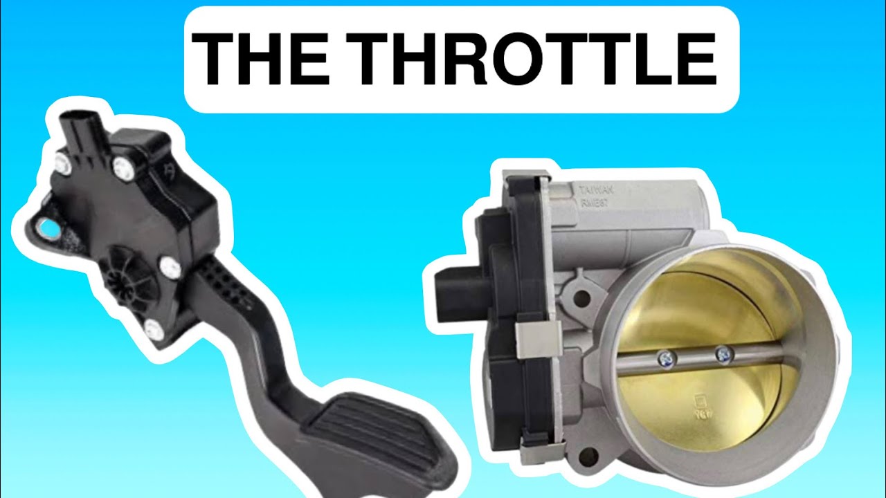

spoke to a mechanic he thinking that throttle needs to relearn possibly or whatever it called reprogram because I had messed with it ,does anyone know how to do this or where I could get info ,Thanks

Found this , I’m want to try this (procedure shown at end )but my air conditioner is not working :unsure: ,guess I have some work to do

I'm no expert but when I did the spark plugs I didn't have to reprogram my throttle body after taking it off. I didn't see any mention of that in the manual either. I also read a lot and watched a lot of videos before doing the job and didn't see anyone else needing to do any reprogramming.
