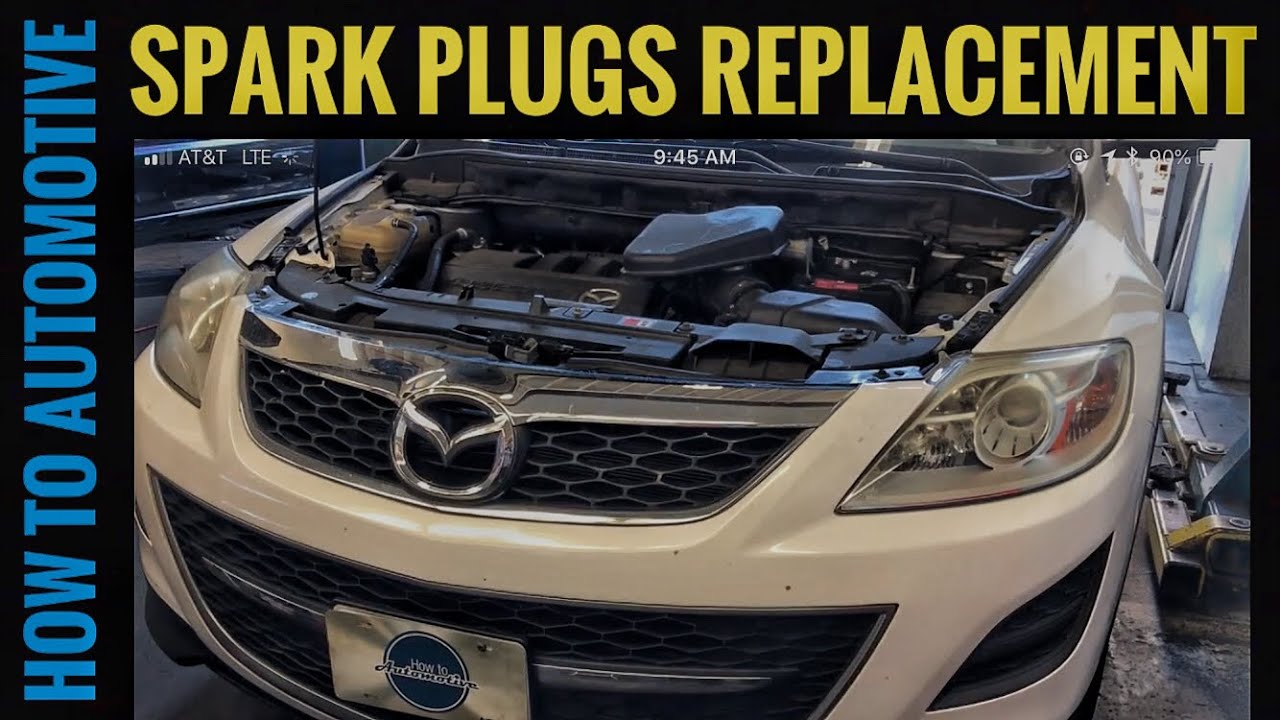

My best guess would be that you forgot to hook something back up. There is a lot of stuff that gets disconnected when doing the spark plugs. I'd recommend just watching the video I linked below and pausing and checking every connection one by one as he removes them to make sure everything is plugged in/ reinstalled correctly.
I've also put a link to the workshop manual below.
