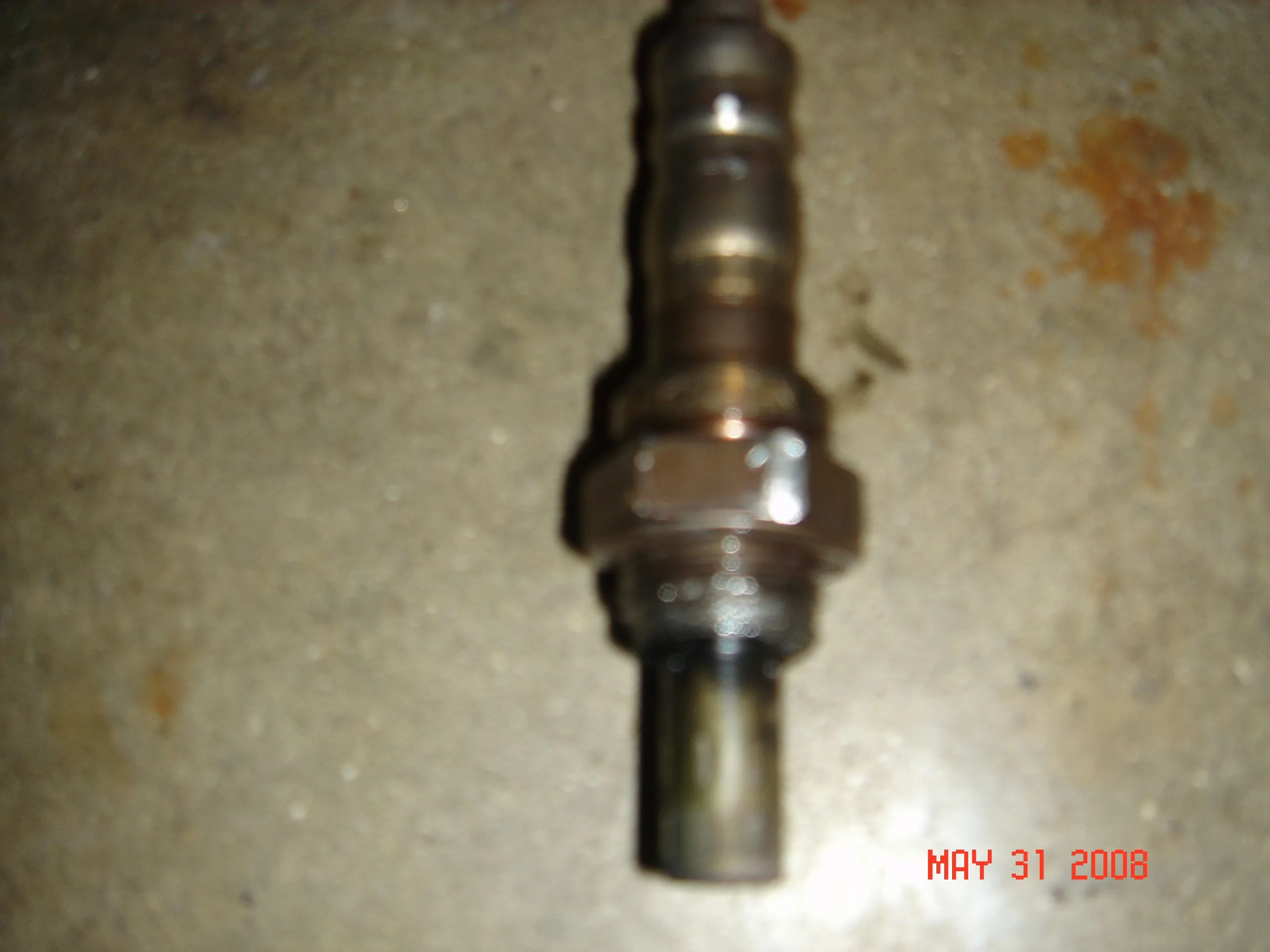

After spending all freaking day taking the stock stuff off we tried to get the 2nd O2 sensor out and that didnt go so well becuase Mazda decided to strip the sensor out...fun...see pics below... Then when we tried to get the downpipe in... the bolts didnt match up. Below is a picture of the CS DP and the gasket. Its a bad pic, but let's just say that 2 of the holes dont match up.

It was the second O2 sensor which was taken out with much care. I had been spraying everything with PB blaster for hours before my friends got here to help. It really just looked like the Mazda install of the O2 sensor was bad because we could get it to move from the first attempt.
