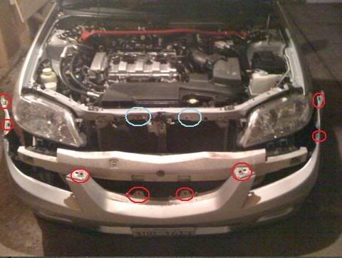

And yes, to take out the headlights you'll have to take off the bumper. Here are a few pics from when I blacked out my headlights this past weekend.
The red circles are where the bolts are to take off the bumper. The blue circles are where the two tabs are to take off the grill. There are also 4 additional bolts under the bumper that hold on the mud guard that you need to take off to access those two bolts that attach the bumper to the underside of the vehicle.

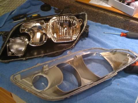

Here's with the lense off the headlight. Its a bad pic but you can see all of the glue I'm talking about on the lense.
