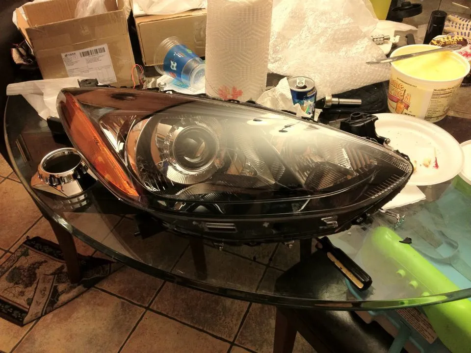

.It depends on how the level is adjusted. If it moves the reflector like a standard adjuster does, then you would be able to retain the factory leveling system. I got my shrouds today. I'll be using BMW E46 shrouds. I'll try and snap some pictures of the shrouds tomorrow and post them up. Now I'm just waiting on my harness. I'll probably start disassembling my formerly retrofitted lights and start getting the projectors ready in the meantime.

You'll have to see what acually changes when you flip the adjuster. If it's just the shield for instance, then a retrofit could not utilize the factory adjustment without some sort of modification. If it moves the whole reflector, then you would retain the ability to adjust it up and down with the OEM switch. Just be sure to use bulbs no higher than 5000K and no one will know the car originally had halogens.
Here's the finished product of one light. I'll do a write up in the How To section when I get some more time. No output pics yet either
