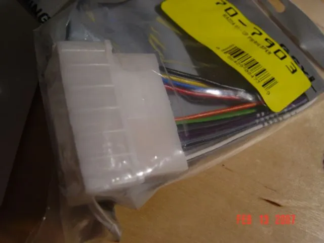

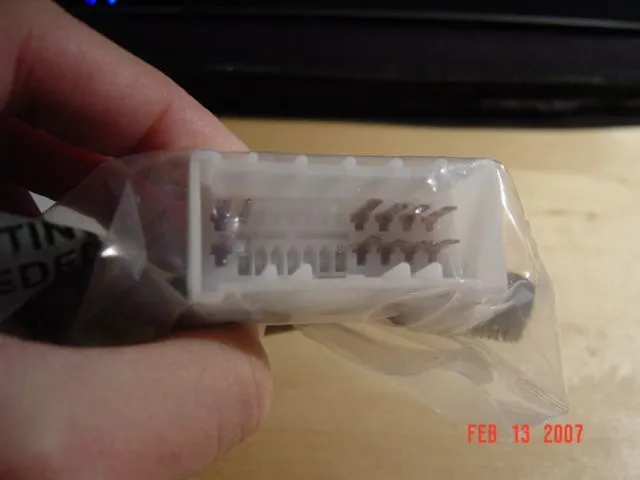

Can someone verify for me if this is th correct wiring harness for the protege? I got it at Ultimate Electronics. Just want to make sure. Thanks!

the part number is right but the pins dont look right at all.
The speaker wires should be on each side of the harness and they are all on one side.
Pulling out the radio will tell the tale
should look like this
Wait, I think I got it.
Is there a plug on each side of that harness?
If so then you have one of the universal harnesses.
With them you need two harnesses. One of them will be Car to universal and the second harness you need is universal to radio type. So you need a mazda to universal harness then you need a universal to alpine.
As the alpinecomes with its own side, then you can lop off the universal side of the car to universal harness. Then use butt connectors to attach the alpine harness and whats left of the car to universal harness.

The harness i got at best buy is not 100% the same. There are some missing pins but the plastic housing is the same shape. Is this right?
Someone elses stock one?:
My bestbuy one:
Yes...your new deck doesn't need all the connections. It just needs power, ignition, ground, dimmer, and 8 wires for the speakers. I think that's it.
