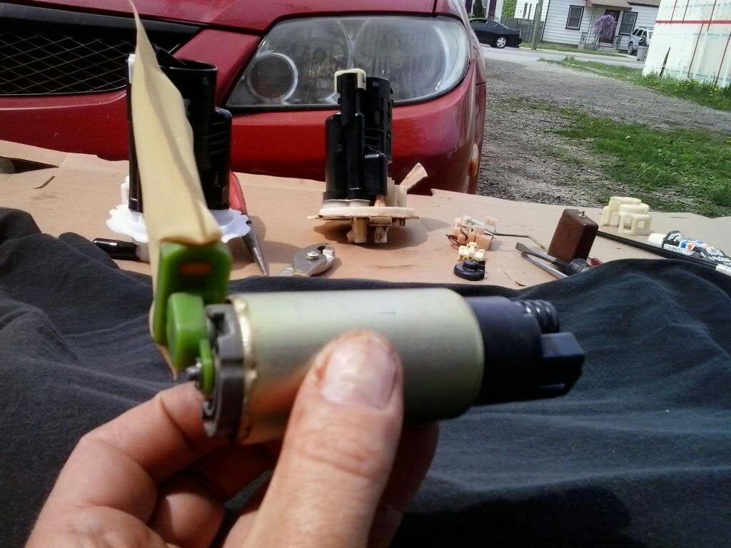

Filter is new, at least the one in the pump/assembly (not the sock, but the assembly thing itself).
You know... Now that I think about it. My fuel tank was leaking a couple years ago, and I replaced it with an aftermarket unit. With the new tank, when it started getting low on fuel (maybe 4 gallons or less) the engine would cut out if you made a right turn, and then after a couple seconds come back. I presumed this was fuel sloshing away from the pump. I suppose its conceivable that could hasten the demise of the pump. I still can't understand why anyone would be that stupid to design a tank that is susceptible to that, but maybe I need to find a nice condition used tank and see if that solves the cutting out problem and then replace the pump.

A fuel pump running dry is REALLY bad for it...
You can burn it out by running out of gas a couple of times.

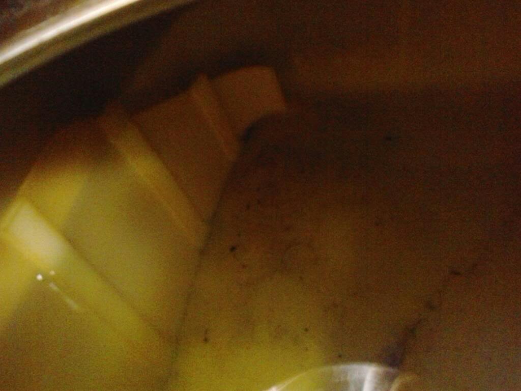

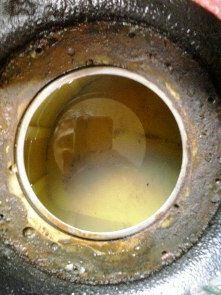

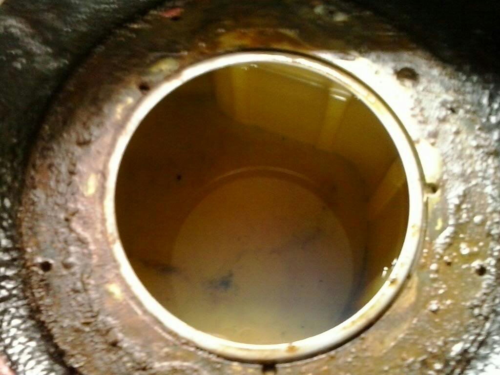

I think you should open up your fuel tank cover and see of you see baffles like this... (+and replace your fuel pump while your there...) And go from there !!!

Pull your fuel tank cover and look for baffles...
If you see baffles, think twice.
If you don't see them replace it all...

It's too late, I already bought the tank. I saw baffles when I looked at it, but that doesn't mean its correct inside. Like I said, other than the tank being installed in some odd orientation (which may itself be a defect in the design of the tank), I just don't see what could cause the problem other than the baffles being wrong. I mean, the baffles are designed to prevent EXACTLY the problem I am having. And yes, you're right it's going to be a pain to fix the problem, but I'm getting sick of all the fuel related issues (can't fill up fully, it cuts out when turning right when I only have a few gallons in the tank, and apparently, now it can be challenging to start the car).

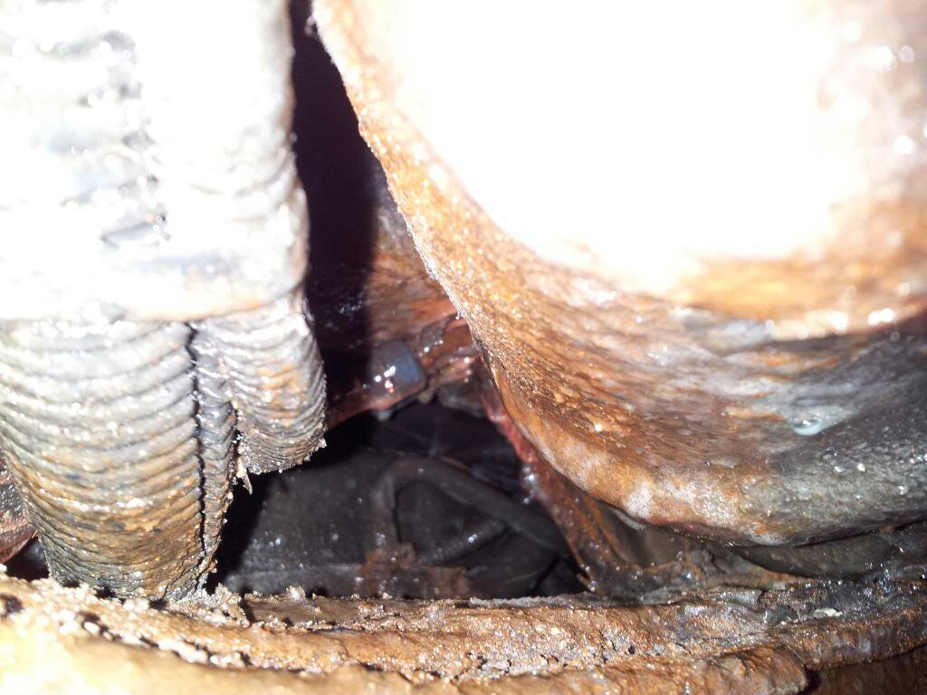

I put on a new fuel tank shield few years ago...
I broke a bolt and had to drill and tap a new threaded hole into the frame...
