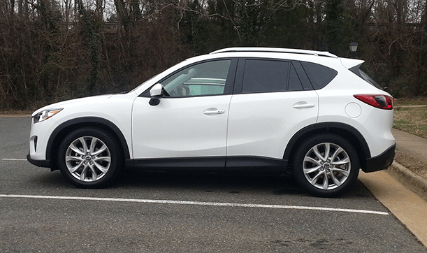

I have not got an alignment yet as I just installed them today. The install was completed by myself and like I said it is so much easier than my VW.
Hopefully this image will give some an idea on how much of drop to expect.
now back to the ride after 190 miles, few 40+ mile trips with 4 passenger and some luggage.
smooth road, highway, similar to stock, if road imperfection, large dips, the car will rebound more, if you have other cars with shorter stiffer springs you know the feel. but is not harsh. my wife didn't notice any difference.
cornering, from my butt G sensor it feels flatter, less top heavy feeling, yea 1.5" drop is not that much off, but that lowers CG by 1.5"
as for mileage I didn't notice anything, I'm about to drive to LA again next week I'll see if there is a change.
