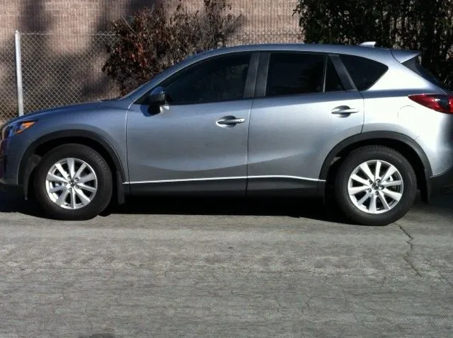

Hopefully this image will give some an idea on how much of drop to expect.
Looks good; thanks. Did you take any measurements to see if you got the advertised 1.25/1.74" drop? Please let us know how the alignment goes.
Oh, man. Thanks for the before/after .gif. That is amazing.
Drop looks PERFECT. Man, I wish I could convince my wife to let me do this. It's her car, so she has final say.
But a drop that subtle...if I am careful, she may not even notice!
That does look good, very tastefully done. Makes the factory 19's standout even more.
Curious to hear after a few hundred miles what ride and handling impressions are...
love it.
let us know how the alignment works out. hopefully stock adjustment hardware can easily compensate.
make note of any mpg differences. you should get better aero and highway mpg. (hint: this is how you justify to wife :P )

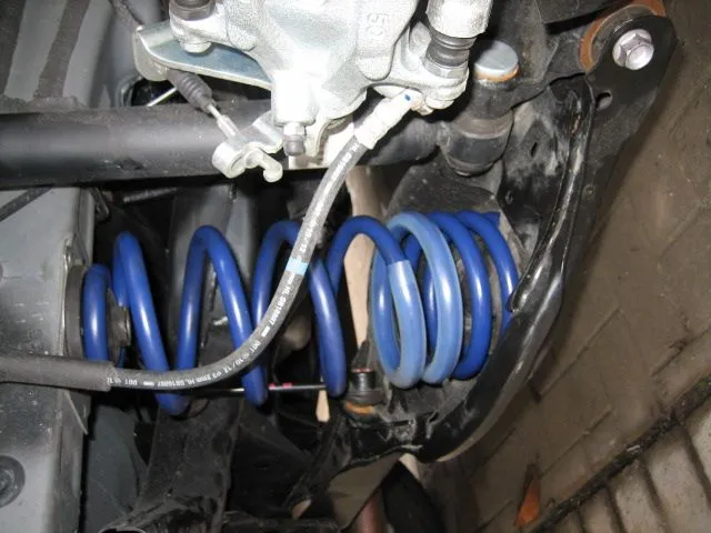

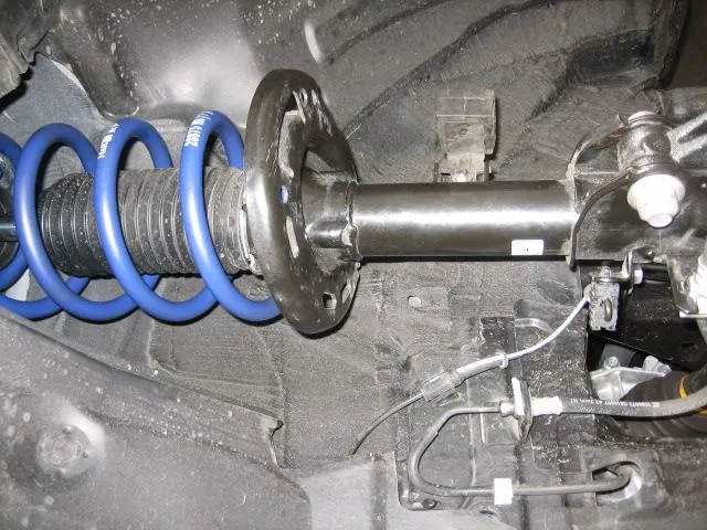

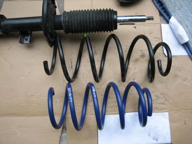

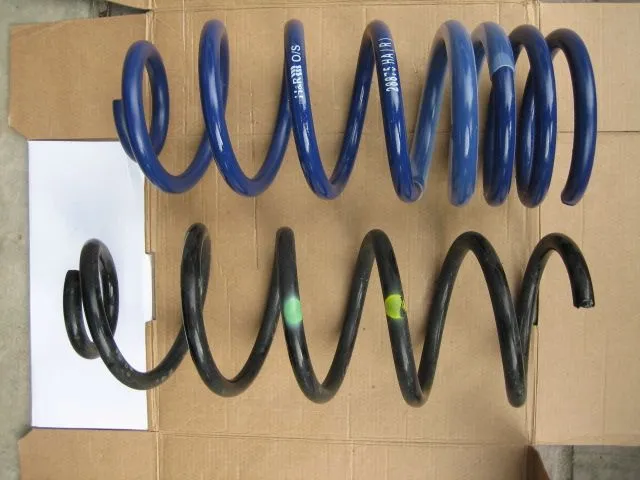

here are some pics, side by side, stock springs are tall.
here is center wheel to lip
stock springs:
Front lip to center: 465mm
Rear lip to center: 480mm
H&R:
Front: 430mm
Rear: 440mm
front lowered: 35mm/1.38"
rear lowered: 40mm/1.57"
again just after install less than 5 miles, I'll post after a week and alignment, (eyeball with tape measure so give it +/- 3mm) I think that is what they advertised.
