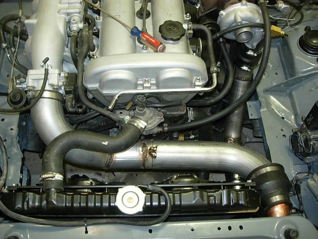

It's do or die time. I have scheduled a dyno session (Dyno-Pak, yay :D ) for next Wednesday (3/9). Unless I'm bleeding, dying, or the engine has a hole in it, the car will be drivable under boost by the end of this weekend (I know I'm jinxing myself with that statement). Following the dyno session, there is a SOLOII Test and Tune event with the local SCCA chapter followed by the first points event for the season. If all goes well, the points event will be this Miata's first competition. I can't wait to see how she performs.
I finally have a working turbo installed and 90% of the intake piping complete. The suspension will be complete this weekend, corner weighted, and aligned. In addition, wiring will be completed to the gauges and assorted controllers.
The light at the end of the tunnel is visible. If everything goes well in the next 1.5 weeks, the only issue remaining will be either cosmetic or drive train replacement ;).

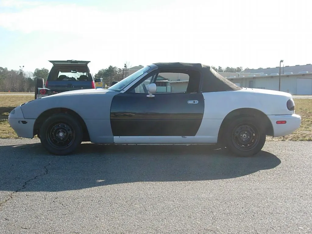

I won't begin to go into the misfortunes that I ran into this weekend (the car is cursed, I'm sure). Things were bad. $75 for a weekend with a possible 30+ runs, and I got 4, lol. Yet there is a silver lining within this cloud and I think I'll be able to work it out in time.
For the time being, here are a few pics of #1 and #2 together.
