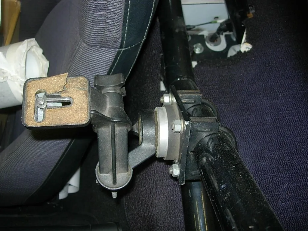

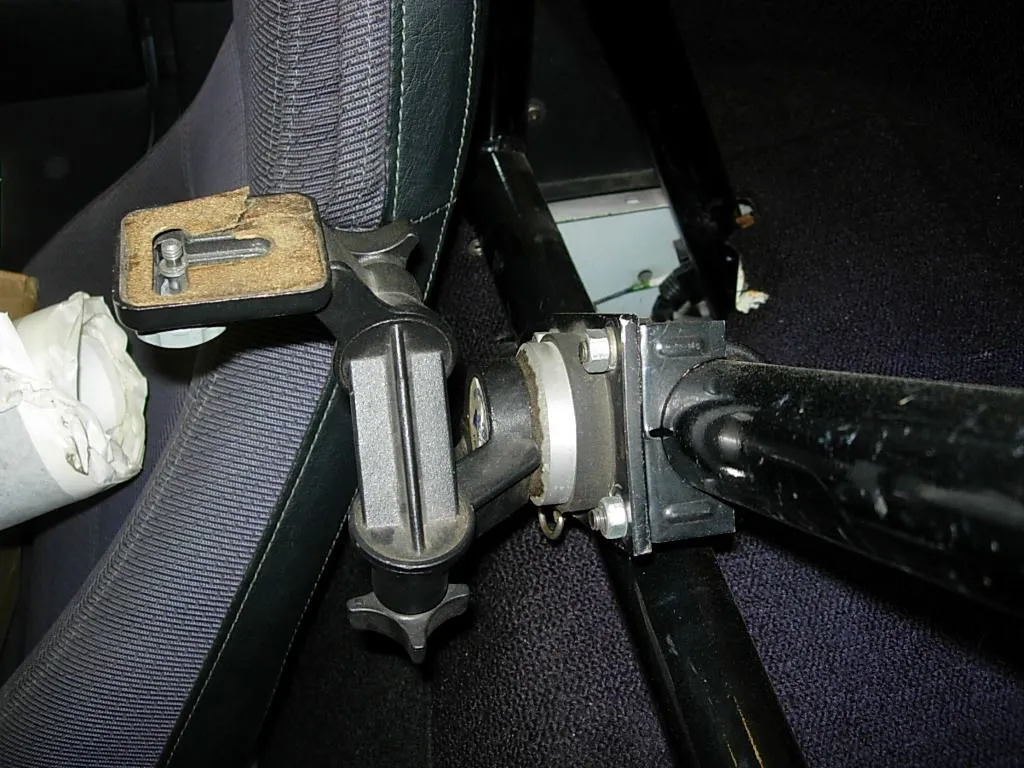

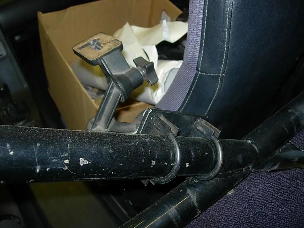

Prodigy said:
do you have any close-up shots of the camera mount?
Here are a couple shots for you.
cool thanks.
How's it work? Does it vibrate too much without cushioning?
Prodigy said:
cool thanks.
The camera is solidly mounted. However, the sways and vibrations in the car are noticable, but not terribly so.
