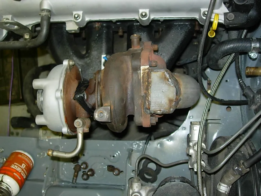

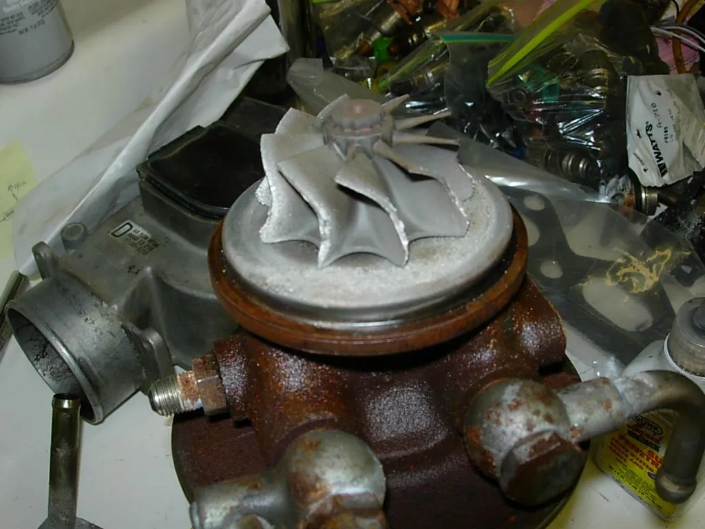

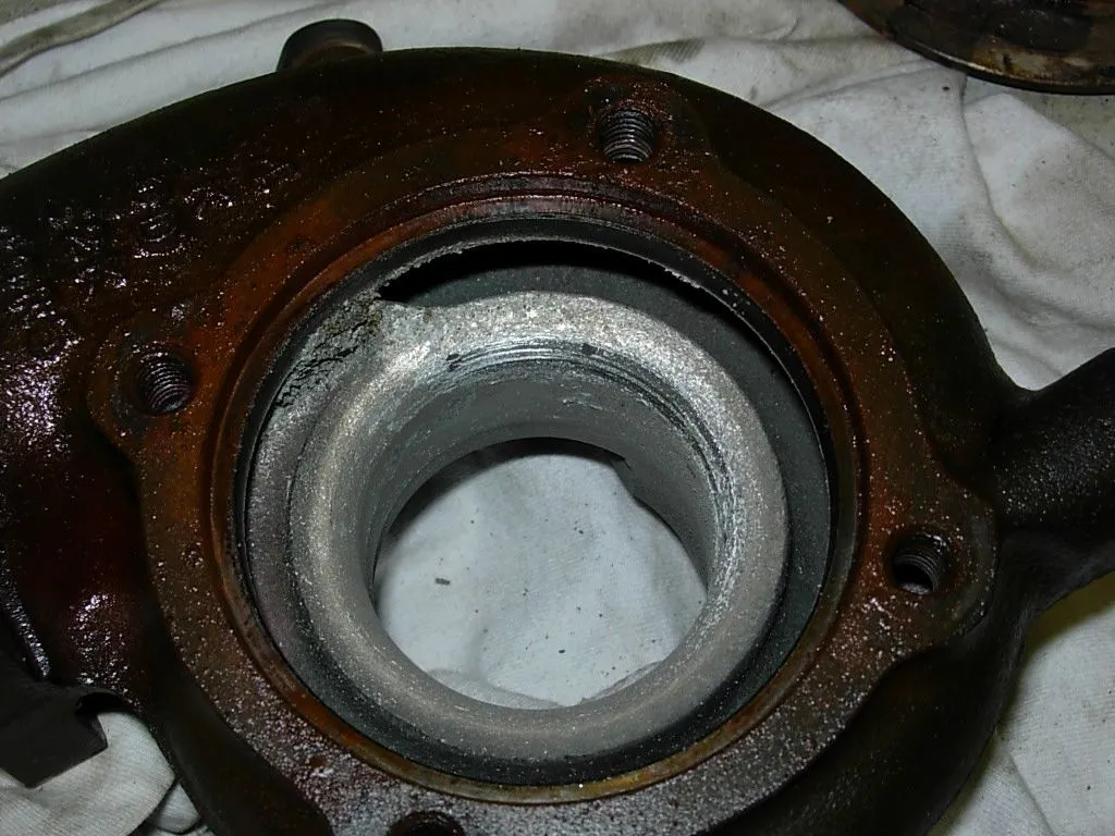

Turbo #2 - headed for the dumpster?
I disassembled the "good" turbo today to rotate the housings so that the oil drain has the proper downward orientation. Upon doing so and much to my dismay, it seems that the car from which it was removed had a bit of a lean-running condition. Molten aluminum is splattered all over the inside of the exhaust housing as well as the impeller. Since the plate behind the impeller is now unloaded after removing the housing, the impeller now rubs and grabs on the aluminum. I hope that I can find some way to torch the aluminum off. Suggestions?
So, the 'saga' continues.....

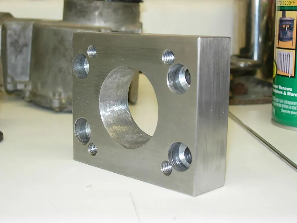

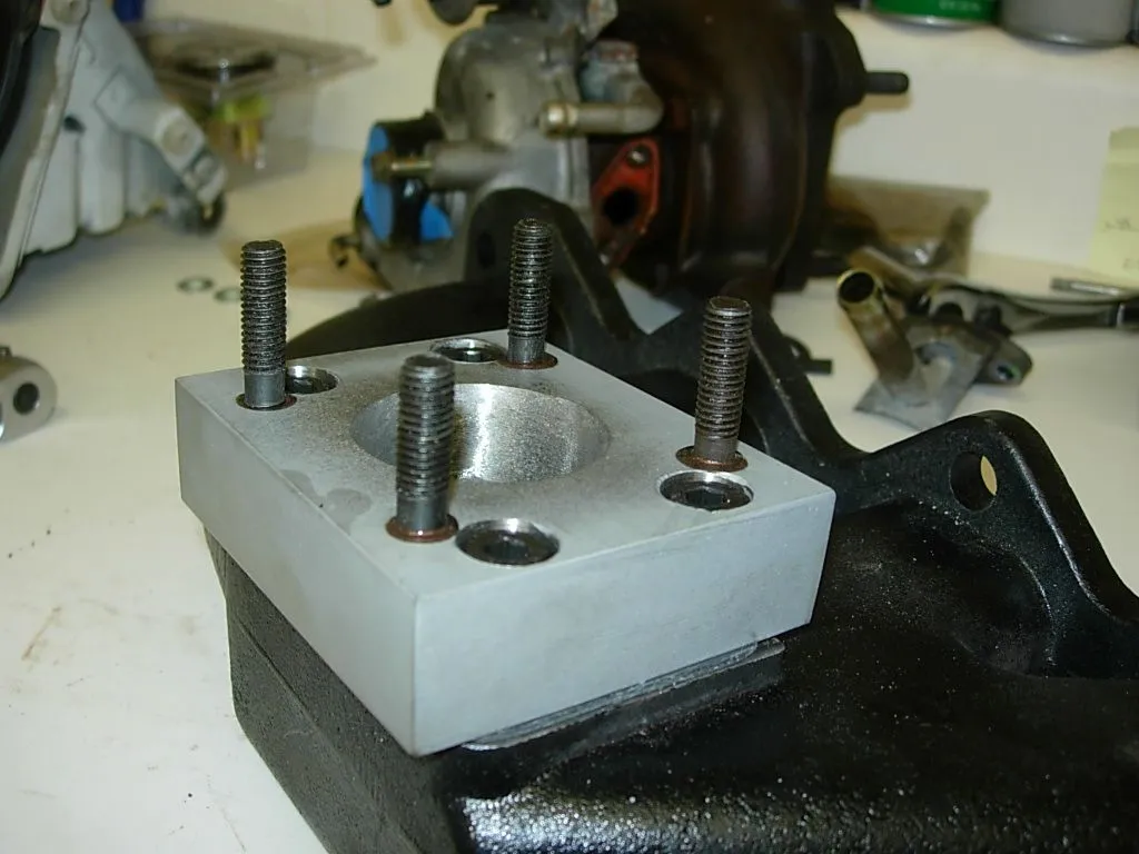

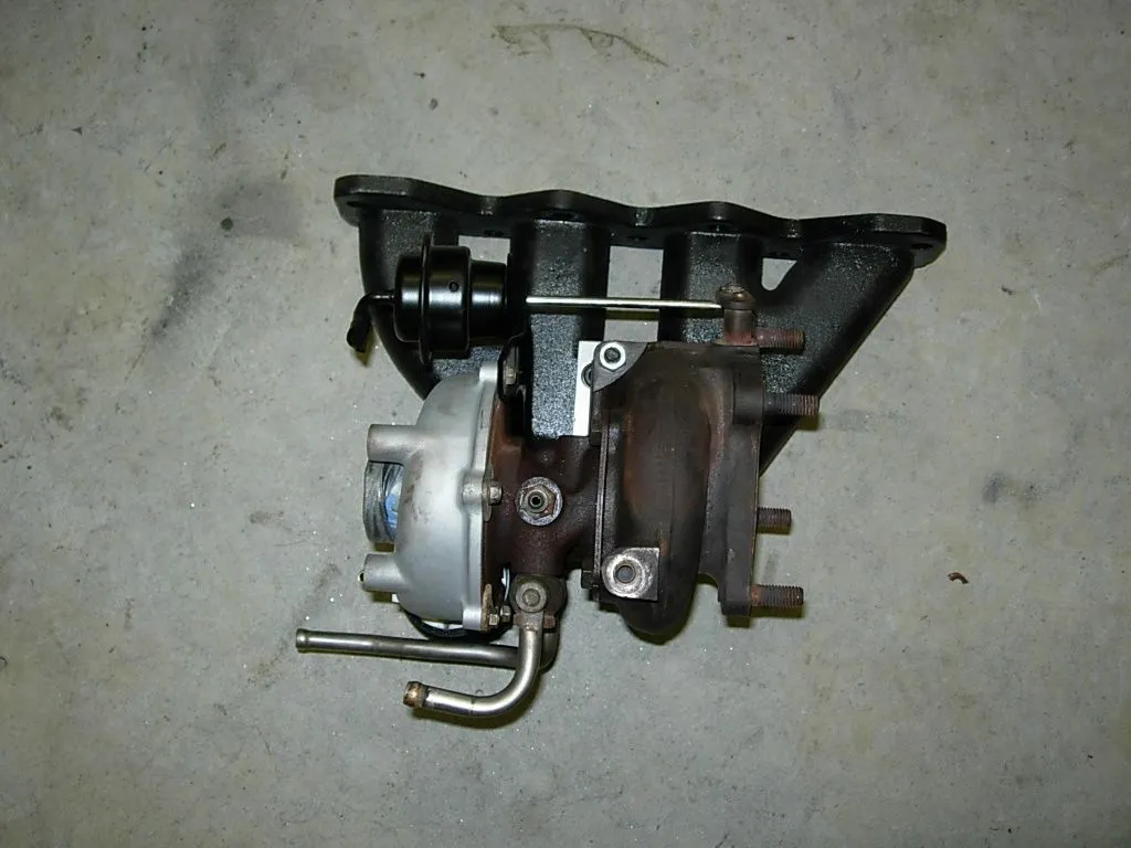

Attached are a couple pics of the issue, as well as a conversion flange that I had to manufacture to fit this turbo to my manifold.

You are probably going to have to grind it down or something.
Just take a die grinder to get rid of the excess molten aluminum...
it shouldn't slow you down too much (unless you don't have the tools.. (doh))
good luck.
That's exactly what I did (except with a dremel). It also seems that the plate beneath the impeller compresses to a more concave shape. So, as it seems, I now have plenty of clearance on the impeller side.
The turbo is now re-assembled and the manifold is in place. This week, I will be manufacturing the downpipe. Once completed, I can bolt the turbo in place, route the oil and coolant lines, and plumb the I/C and remaining intake lines. If all goes well, I should be boosted within two weeks.

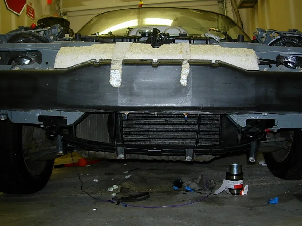

So here's the latest update. The downpipe is complete (with exception of a second O2 bung and outlet flange), the intercooler is mounted, a radiator from a 79(?) Mitsubishi truck has been test fitted, and the cowl area is painted (amongh painting other odds and ends). Typing that, it doesn't seem like much (doh). I have since recieved a new set of KYB AGX struts that will be installed as soon as the car is running, which will hopefully be within a week or two. All in all, to get this thing boosted, I need to create a mounting system for the radiator, plumb the turbocharger's oil and coolant lines (an hour max), and plumb up the intake track. However, I must also install a blowoff valve and fifth injector to the intake plumbing. Ha!
Here are a few pictures to tide you (the few watching ;) ) over. Yeah, I know, not the best welding, but it'll work.

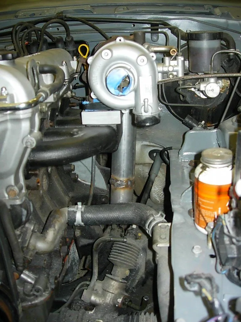

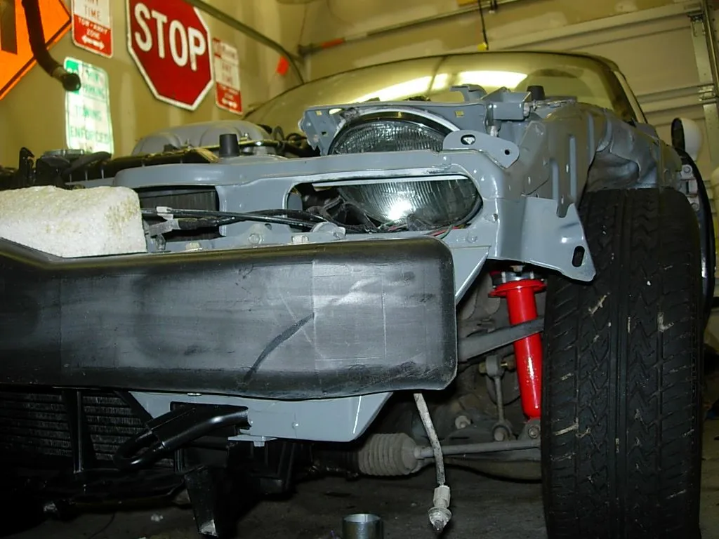

So yeah, I'm still at it.
Things are still progressing on the GRM Miata, albeit slowly. All of the easy stuff has come together to create a bunch of small difficulties, of which should be expected. To make this short and sweet, the turbo is permanantly mounted, the water and oil lines are plumbed (I previously stated an hour...HA! I wish), turbo to I/C pipe is done (except for powder coat), I/C to intake is 75% done, the radiator is fitted and mounted, the two new radiator fans (Honda Accord :D ) are fitted and mounted, started to install the suspension, but ran into problems, and the down pipe is complete with outlet flange, O2 bung, and header wrap (to protect items in close proximity).
I had to use the waterpump "distribution manifold" from the Capri to allow clearance for the turbo to I/C pipe. The Capri unit is significanlty shorter (as seen in the forth pic) and allowed the perfect clearance for the piping. I had to tap and thread a fitting into it to allow for the turbo coolant return line.
I have also acquired a Bipes ACU to dynamically retard the timing, basically (hey, the chances of me grenading the engine have lessened :D ).
It turns out that the threaded sleeves that I'd planned to use with the adjustable coilover setup won't work [easily] with these dampers. Unless I find a different set of sleeves/perches or manfactur a different lower perch for the KYB's, I'll be forced to use the stock springs (as funds are running low).
God willing, this car WILL be running by Sunday's end (2/20).
Per the norm, here are a few pics. Enjoy, heh........
