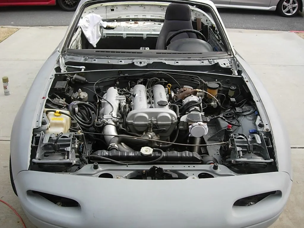

There's a bit more to the car now; a few more accessories are attached ;)
That's a heck of a good price. You should jump on that.

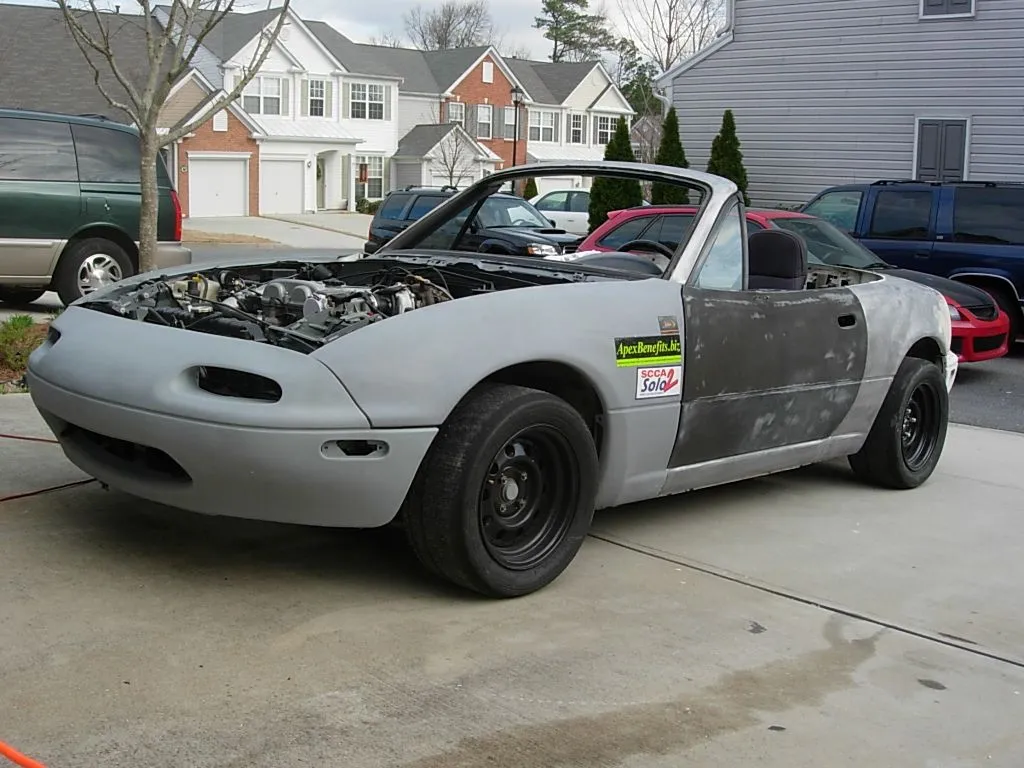

As a side note, there is a TON of bondo on the car. It's nuts. I don't think a single panel is untouched, hehe. However, I got it completely stripped today, and some of it primed. She's looking pretty good, FWIW.
It looks like a Mad Max car the way she sits now. I hope to have the primer finished Sunday with the door jams painted with the final top coat. We'll see.

I thought you might cringe with that. Unfortunately, the paint wasn't adhearing anywhere except to the plastic bits and bondo. I was pulling off sheets of paint with my fingers in the order of 6"x7". Don't worry, she'll be painted again, and still have the stripes :-D.
EDIT: after you stripped all of the paint, how did you prep the surface and what kind of primer did you use?

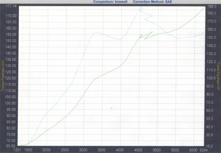

All of this talk and what not and I completely forgot to post the latest dyno results.
Again, the "flywheel" reference is to that of the DynaPack's pod flywheel. This pull (as well as every pull in this session) unfortunately ended at about 4500 RPM at which the (new at the time of car purchase) clutch could no longer hold the power. The power plot goes crazy when the clutch lets go, hence the strange curve on the graph.
Compare the 4500 marks of my previous dyno graph to that of this graph. That being said, it's almost guaranteed that I'm well over 200 RWHP.

The mistake we made was not using etching primer. That's why the paint was peeling. It was primed but not etched.

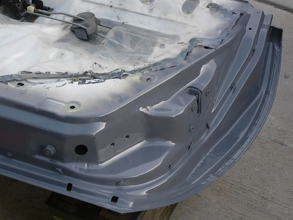

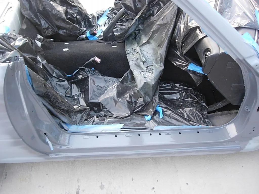

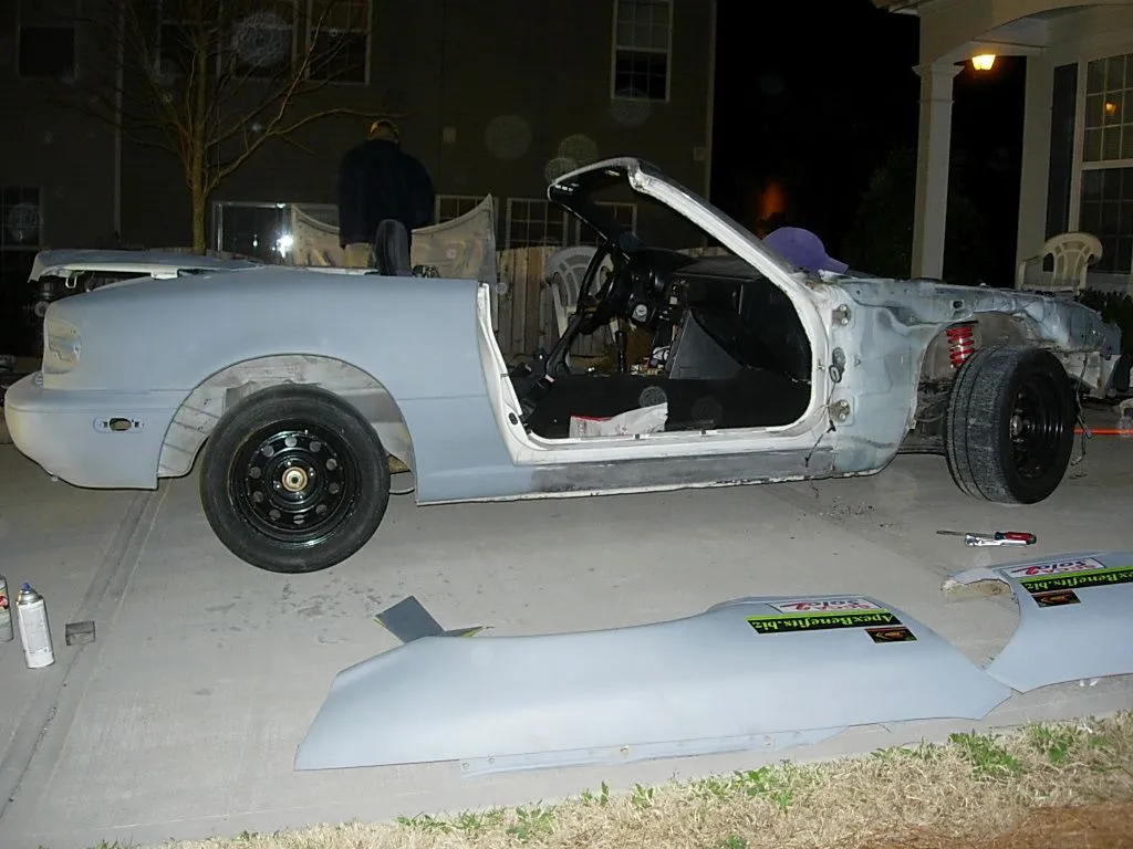

Below are a few pics from last weekend (3/19-3/20) of which the majority of the [paint] prep work was completed. All body panels that are removable from the Miata have been removed, hehe.
Included are a couple shots of the gray and black that will complete the dual color paint scheme. All of the sills, jambs, and assorted other crevices are currently painted with their respective top coat (be it black or gray). Saturday, the upper [black] paint will be applied; Sunday, the lower [Gray] paint will be applied. Pics of the progress will, of course, be posted for those interested :D .
