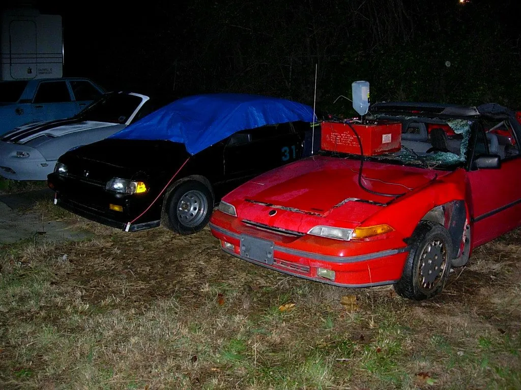

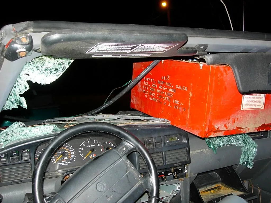

It's a sickness I swear. Well at least the engine isn't toast on this one. I was able to crank it today dumping fuel through a vacuum line (fuel pump is toast) and I could get it to sputter and hold for a bit, but not run optimally. So we'll see what the newest POS brings this Tuesday. I've got a fuel cell with integral fuel pump that I'll connect temporarily and get some gas to the engine. I'm looking forward to seeing what happens :D.
Pics here.
http://www.msprotege.com/forum/showthread.php?p=1364497#post1364497
Well, I got the latest XR2 to run! Better yet, I hit 10 PSI (according to the stock boost gauge)! So the turbo is good!!! yay. Since the fuel pump wasn't working, we rigged up a fuel cell with an internal fuel pump and ran it from that. Since the stock tank is full of 6 year old gas, we had to catch the unused fuel in a 1 gal jug. fun-fun-fun. Now I have a CONFIRMED working turbo (hearing that whine was sweet) and I'm now ready to go full throttle on this project. However, I'm going to clean out all of the junk and broken glass, swap the fuel pump from the other XR2, and hit the drag strip one night before I tear this one apart. Miata MXR5 is just around the corner :D.

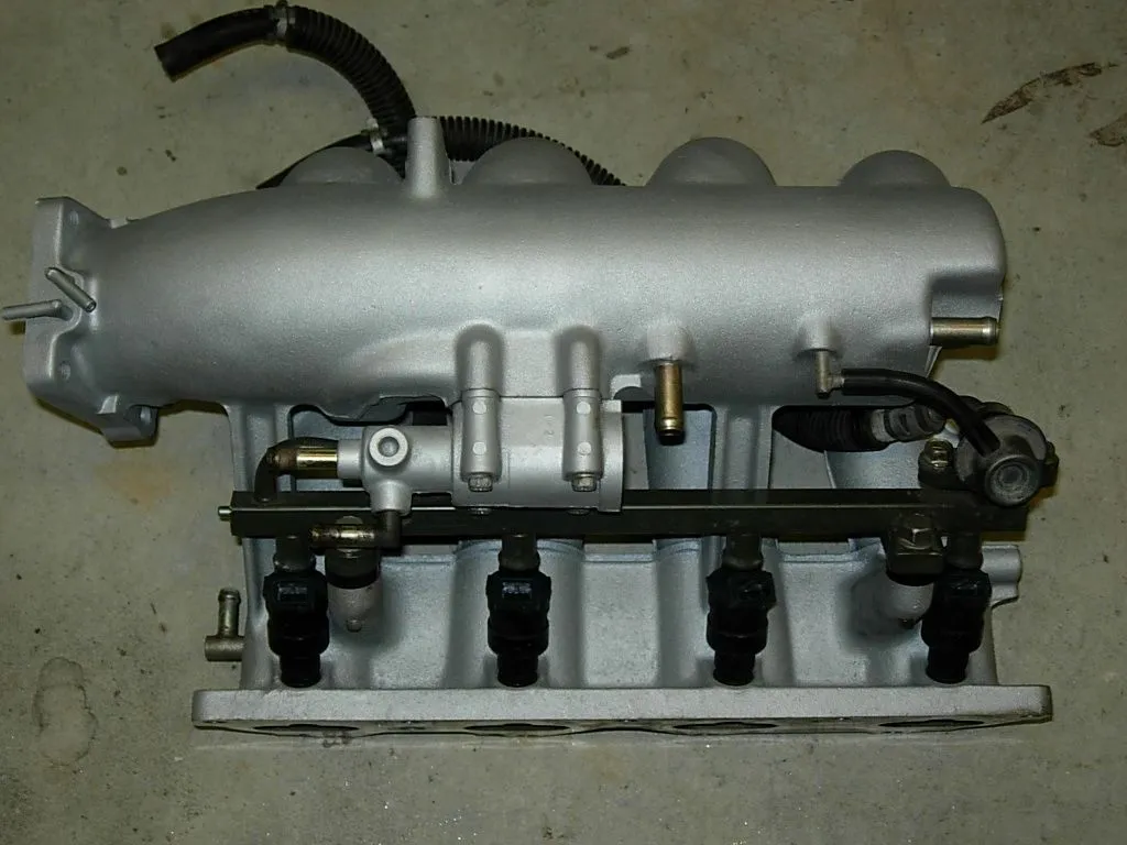

It's been a while, but here's an update. I've been busting my hump (when I'm not away on freakin' business) prepping the engine bay and what not. I finally got it completely painted after removing everything (except the engine), sanding, sanding, sanding, and of course painting. The sheet metal is a dark gray (the flash in the pics lightens it up quite a bit) similar to that of Mazda's graphite color and the brackets and what not are black. All of this to compliment what the exterior of the car will look like when finished. I also made a new harness to work with the larger injectors that I am using, installed the fat(er) injectors, turbo oil line, and a few other odds and ends. I picked up an FC RX7 radiator today (sorry Justin), but have yet to determine whether or not it'll work well for me. I hope to have the car back to a running state tomorrow (Sunday) to make sure everything is connected properly before I move onto the turbo installation. If all goes well, the turbo shall be installed and plumbed (minus intake/exhaust) by next weekend's end.

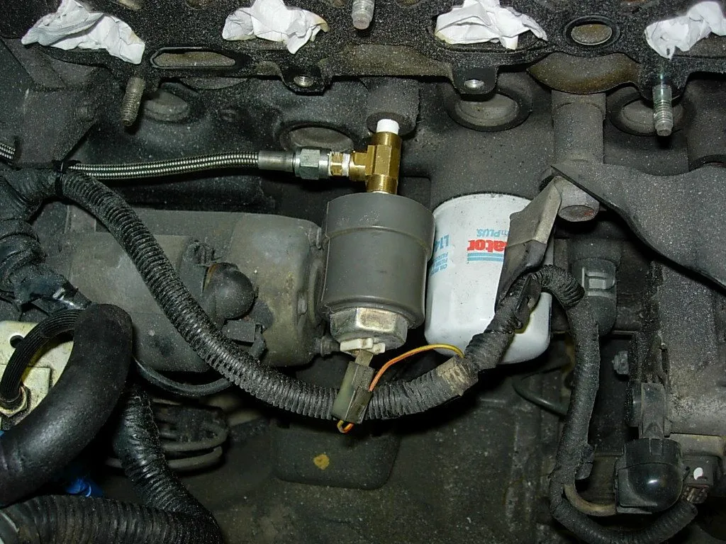

Here are a few pics for the time being. The first pic is how the engine bay looked before the project started. The second is how it stands now, still a bit of work to be done, though. The third is of the cleaned intake manifold with new injectors installed while the fourth is the oil feed setup for the turbo.

I can't tell fromt the pic but make sure that the oil pressure sender is supported. I found that the nipple threaded into the block isn't strong enough to support the weight on it's own...especially with vibration and bumps in the road.
Good call. I've been a bit concerned about that aspect. I'll look into some way of supporting it.
I had to spend some time underneath a Pro5 with some easy-outs because of that...in the middle of a 24 hour AutoX...luckily it wasn't mine...but we live and learn.
