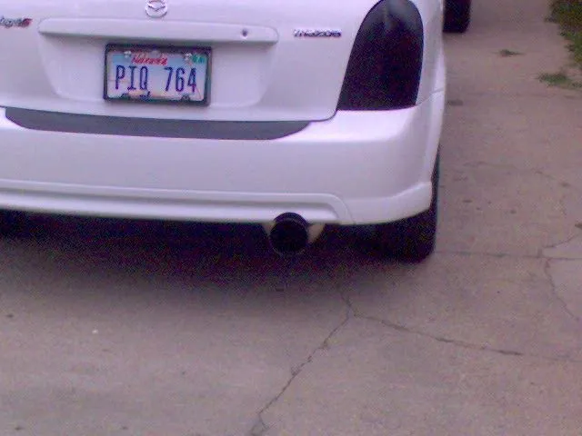

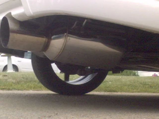

The Evo2
Check, Check, Check It Out!
ND4MSP said:
Hows it sound???????
sounds real good, almost stock when idleing, then it gets nice and sexy as you shift through gears, then once your cruising, its actually pretty quiet, its not ricey at all. Im going to try to get a sound clip soon, ill post it on this thread when i do.
