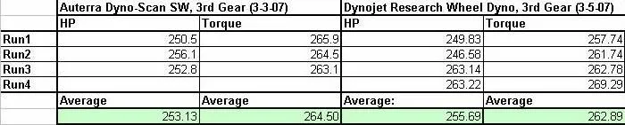

Official Dynojet Dyno of MS3 with MAZDASPEED CAI
I took the car in and had it dyno'd with the MAZDASPEED CAI Installed. The first 2 runs were with the hood open. The last 2 runs were with the hood closed. It was done in 3rd gear each time starting at 1500 RPMs (measurement must have started around 2k RPMs) and letting off throttle at about 6K RPMS. There were 2 large fans positioned 6 feet in front of the car and I estimate the were pushing the air at about 35-45 MPH.
Runs were 4-10 minutes apart and ambient temperature was around 63 degrees F.
I'm going to re-install the stock airbox and filter and go back for 4 more runs within the next few days. To give the shop credit, the test was done in Tacoma Washington at Turbo Technology Inc.

Also, the SW dyno numbers are very close to the wheel dyno numbers:

Yea, I'm just concerned why Rotus isn't getting the same results. Like I wrote before, I'm going to actually put the stock airbox back on, buy a new stock airfilter and re-do the SW and HW Dyno tests during the same weather conditions and same gas in the stock configuration so we can get a solid look at the tru gains of the MS3 CAI. When they were doing the Dynojet Research wheel dyno runs, I paid attention to the exhaust and there was less black smoke, but there still was black smoke, indicating it is still running somewhat rich.

it doesn't make sense that torque and horse power are almost equal on a ms3 I wonder if that is due too the smoothing on the graph. Nice work with all the dyno numbers by the way, this is very much appreciated. Its people like you that make buying easier for the rest of us. Its good to know you device is pretty accurate
I had him switch between smoothing settings and the graphs on all settings (1-5) looked pretty much the same.
