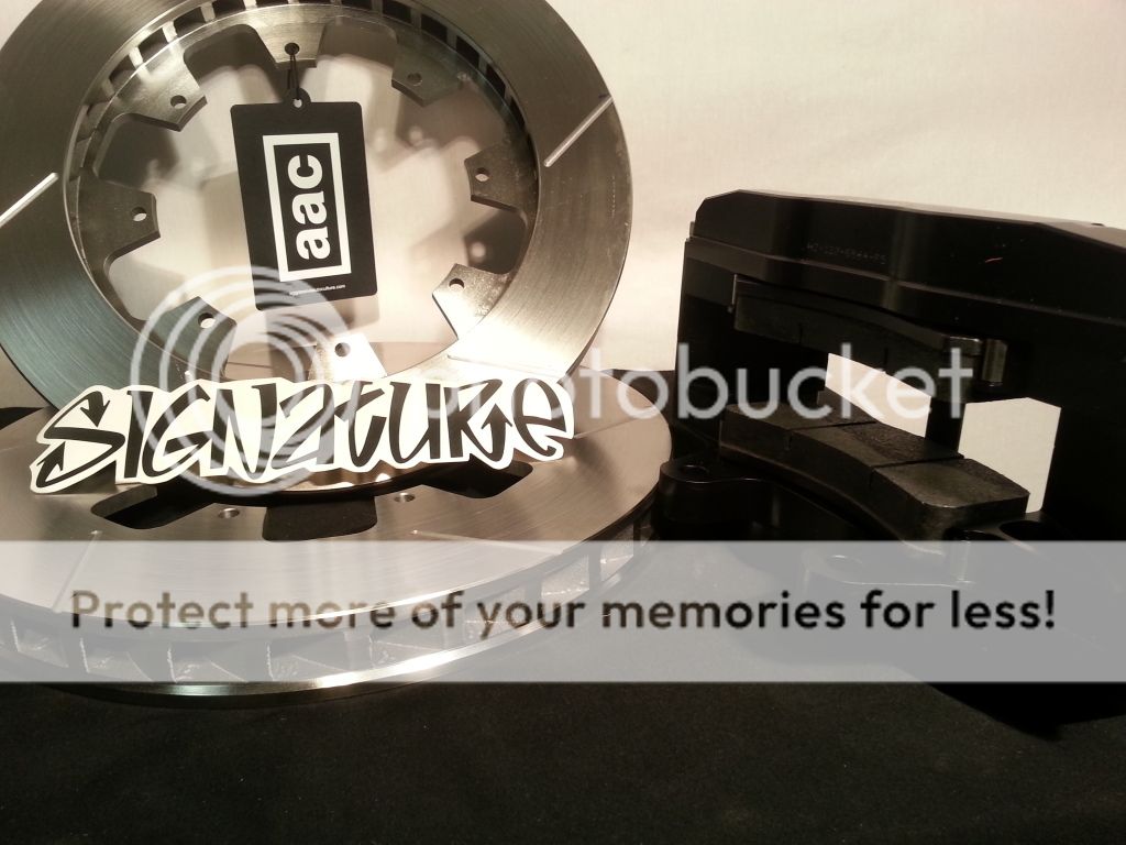

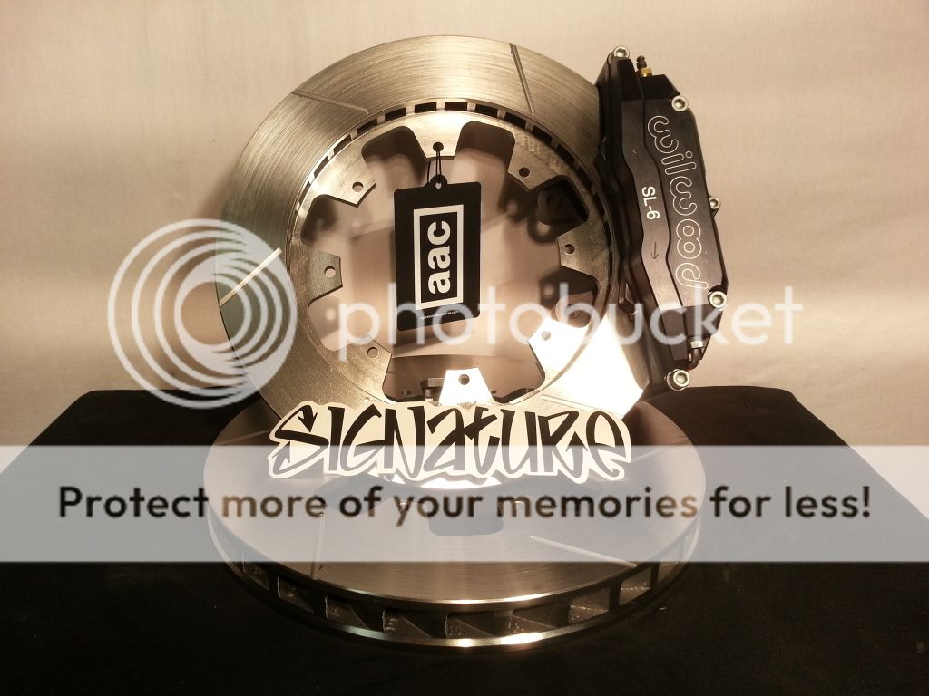

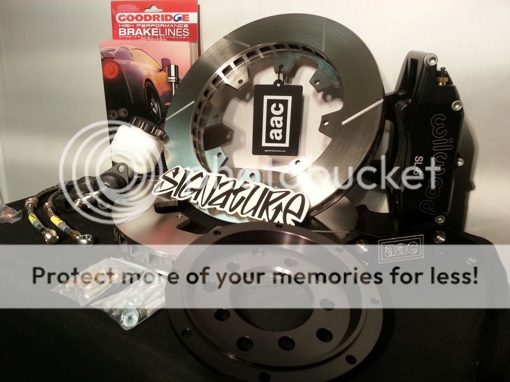

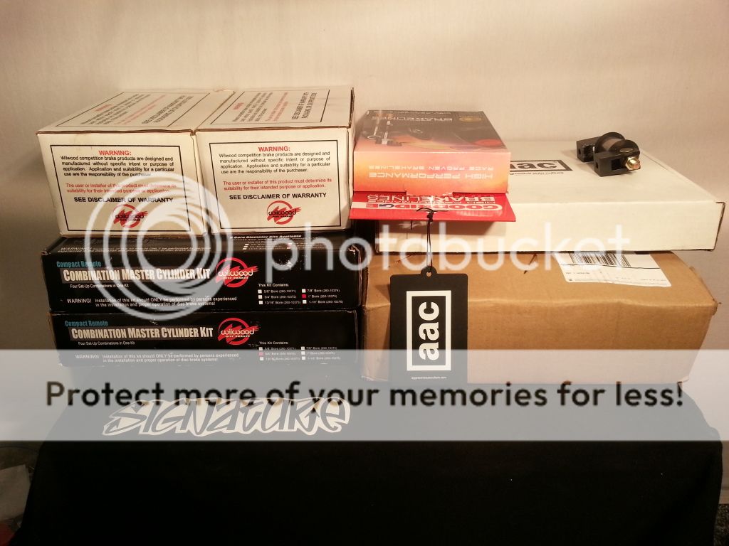

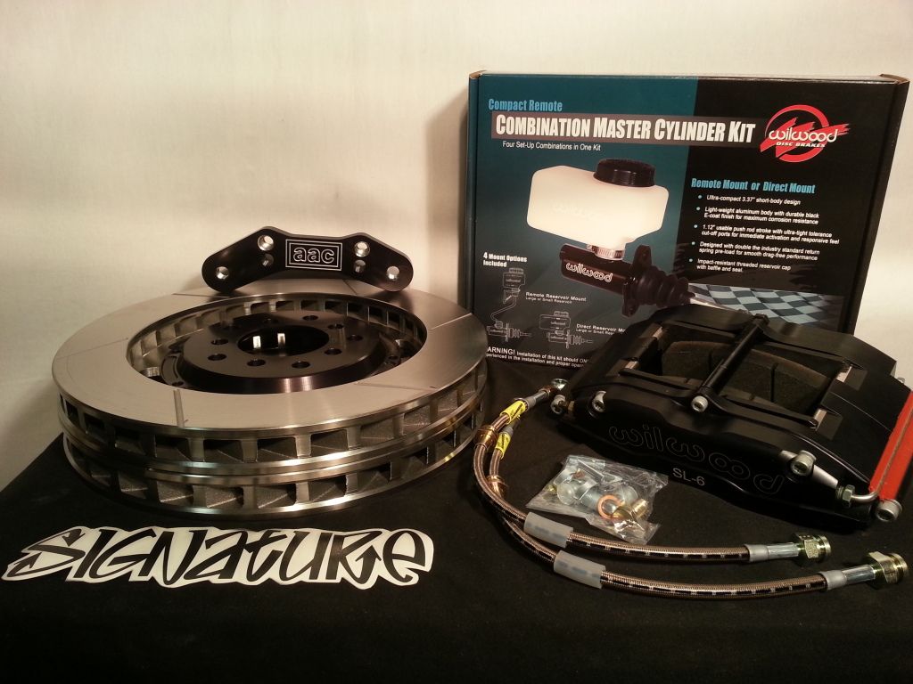

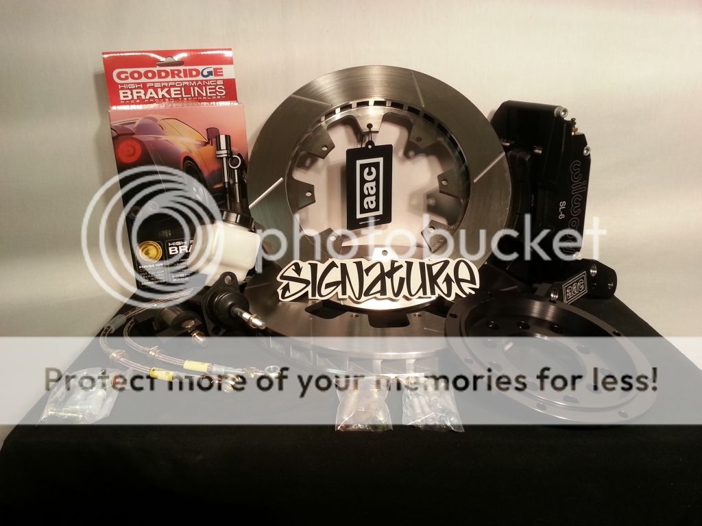

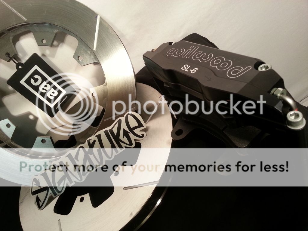

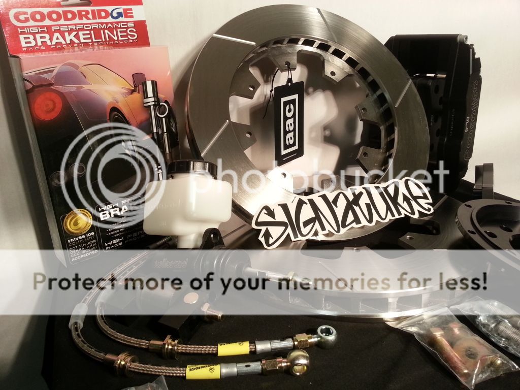

Signature Soundsome critical parts showed up. BIG thanks to Noah at AAC for setting up the group buy and making this easy. The complete kit is outstanding quality. The rear kit will also be available.
Dual master cylinders. balance valve, massive rotors, braided lines... top notch stuff here. Contact Noah today to get yours: AAC@agressiveautoculture.com
haha nice! thanks for the props and for photographing the parts. stoked to see them in a high caliber build!
My lawd, I can't wait to see this car when it's done. I wish I lived closer to CA so I could see it in person. (2thumbs)
