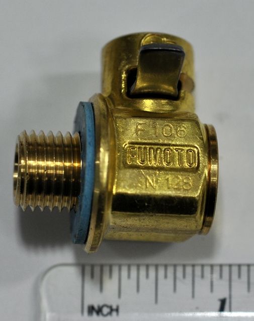

F-106 w/o adapter
By looking at the thread length of the Fumoto valve I can contest that it is definitely longer than the thickness of the oil pan and will extend through the oil drain hole.
Two Other Options Available...
If you're worried about the length of the valve threads, one could:
1.) Place another one or two additional washers on the valve (which would then shorten the amount of the threaded valve that was inside the pan)... but obviously lengthen the overall size of the valve.
2.) Place the correct threaded nut on the valve, cut the excess threads off, then back off the nut... which will realign the existing threads so you're able to install the valve.
I've often used #2 throughout the years when I had a longer threaded bolt where a shorter one was needed. Worked every time for me.

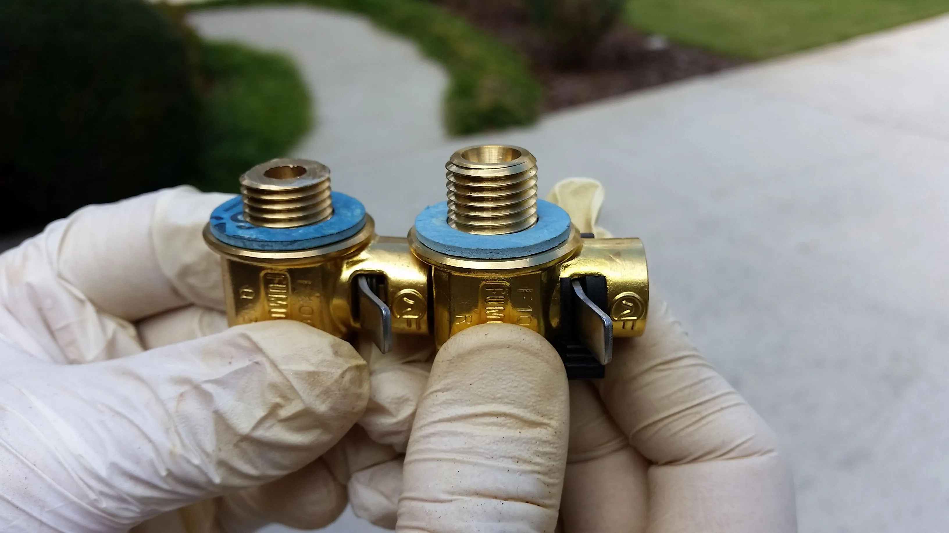

Given the concern for not getting all the oil out of the oil pan, I cut about 1.5 threads off the valve after doing my best to measure how deep the threaded part of the pan is. The brass is soft and I was able to clean it up using a small file. I'm looking forward to the next oil change as it should be easy.

Hi, what tool did you use to cut the thread?
Good Job...
"Blue Reflex" said in part...
Your finished job photo looks good. The only thing I would have done differently (not that there's anything wrong with what you did), was to ream out the inside hole so that it was more like the original.
As far as what you used? I love my "if it can't be done with a Dremel Tool, it can't be done" and would have used that.
Once again... Good Job!
CX5T Lover
I used a hack saw, then cleaned up the surface with the side of a grinder. Today I did the other one and did try to create the cone in the middle. I was only half successful. I think it is ready to go though. Waiting for my next oil change...
