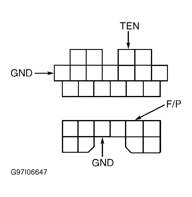

2. Locate DLC-1 under hood. Connect a fused jumper wire between DLC-1 terminals F/P and GND. See Figure. Turn ignition switch on and observe fuel line pressure.(Fuel Line Pressure on Protege & Protege5 should be between 39-45 psi(2.7-3.2kg/cm2).

Identifying DLC-1 Terminals:
